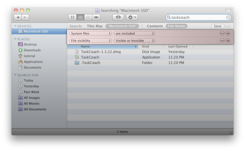

Yep, saw what you experienced.
To get rid of such, you could add another search criteria:

Just like getting System Files showing up as option, you look for the File Visibility option.
