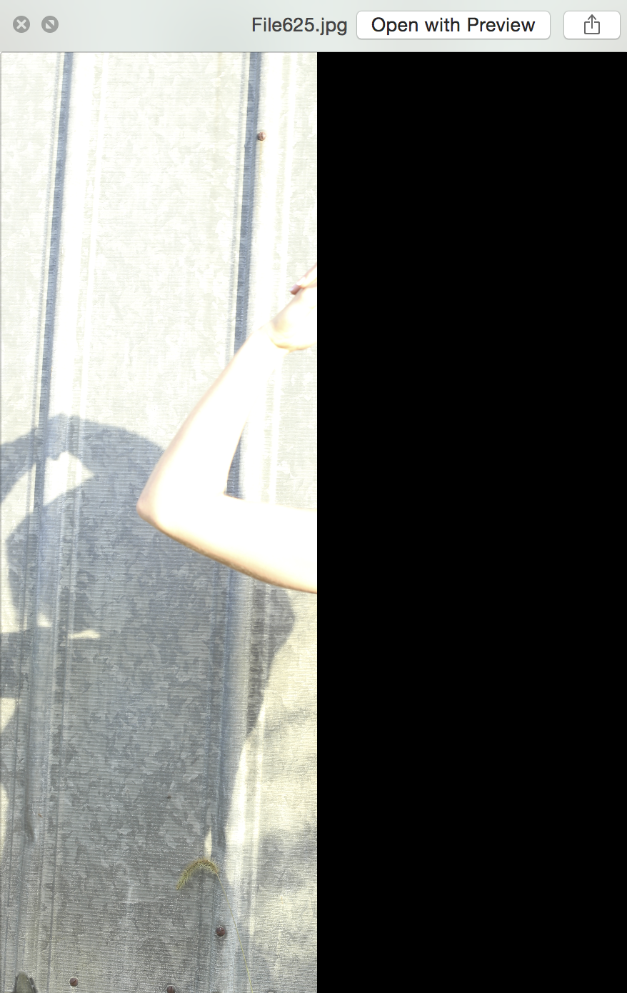

Recently did a shoot where a handful of photos were not captured properly on my SanDisk SD card.
The thumbnails were intact but when the actual photo is viewed it is either discolored, missing, or fragmented (see example attached).
I tried downloading RESCUEPro software and that recovered a few of the images but not all.
So, I took it to a local camera shop and they recommended a shop in California that specializes in SD card recovery. They are 99% sure they can recover the images but they quoted me $1000 for the service. Am I getting ripped off or is that the going rate for such a task?
Thumbnail:
When Clicked:

After trying all of the suggestions posted in this thread...I sent it off to recoverfab in Germany. They gave the most detailed explanation why a recovery wasn't possible:
Unfortunately, it is not possible to rescue the data from your order # 9991. The controller on the memory device is broken-down and therefore no data transfer possible. In these cases, we unsoldering the memory chip from the printed circuit board and extract the raw data to our system. But your memory device has a special construction (see your dismantled device in the attachment), the memory chip is enclosed in thermoset material, therefore not separable and the data rescue no longer possible. Please bear in mind, this construction is used only in about 20% of all memory devices. Because manufacturers often changing the construction and even in the same enclosure are different components, is a prediction of the construction of memory devices not possible. The following causes for the failure of the storage medium come into question: a)A short-term voltage peak occurred from a connected device destroyed an electronic module in the memory device b)A previous production damage in the device, which has deteriorated by the continuous heating and cooling during the use and eventually lead to failure. c)An alpha particles, emitted by radioactive contamination of the storage medium materials, has struck an electronic component and destroyed them.
The California company failed to retrieve my data but Recoverfab is almost magical in its abilities. My story: I had a 128GB Lexar CF card that failed after a video shoot. Halfway through the transfer using a USB-C card reader, the card disappeared from the computer and wouldn't mount on any Mac, using any card reader, and I spent days trying different combinations. So I searched for online CompactFlash recovery options using google and one of the first listed was that LA companythat promised they had the technical abilities to extract the data using a lab. But after several weeks (and "diagnostic fees") they were unable to recover any data. I thought that meant it was impossible but I tried Recoverfab, a small German company run by a storage-chip genius. I sent him the card via Fedex and within an extremely short period of time I was shown thumbnails of all the missing files. His prices are standardized and fair and the customer service is FANTASTIC. It was quick and easy and basically miraculous.
