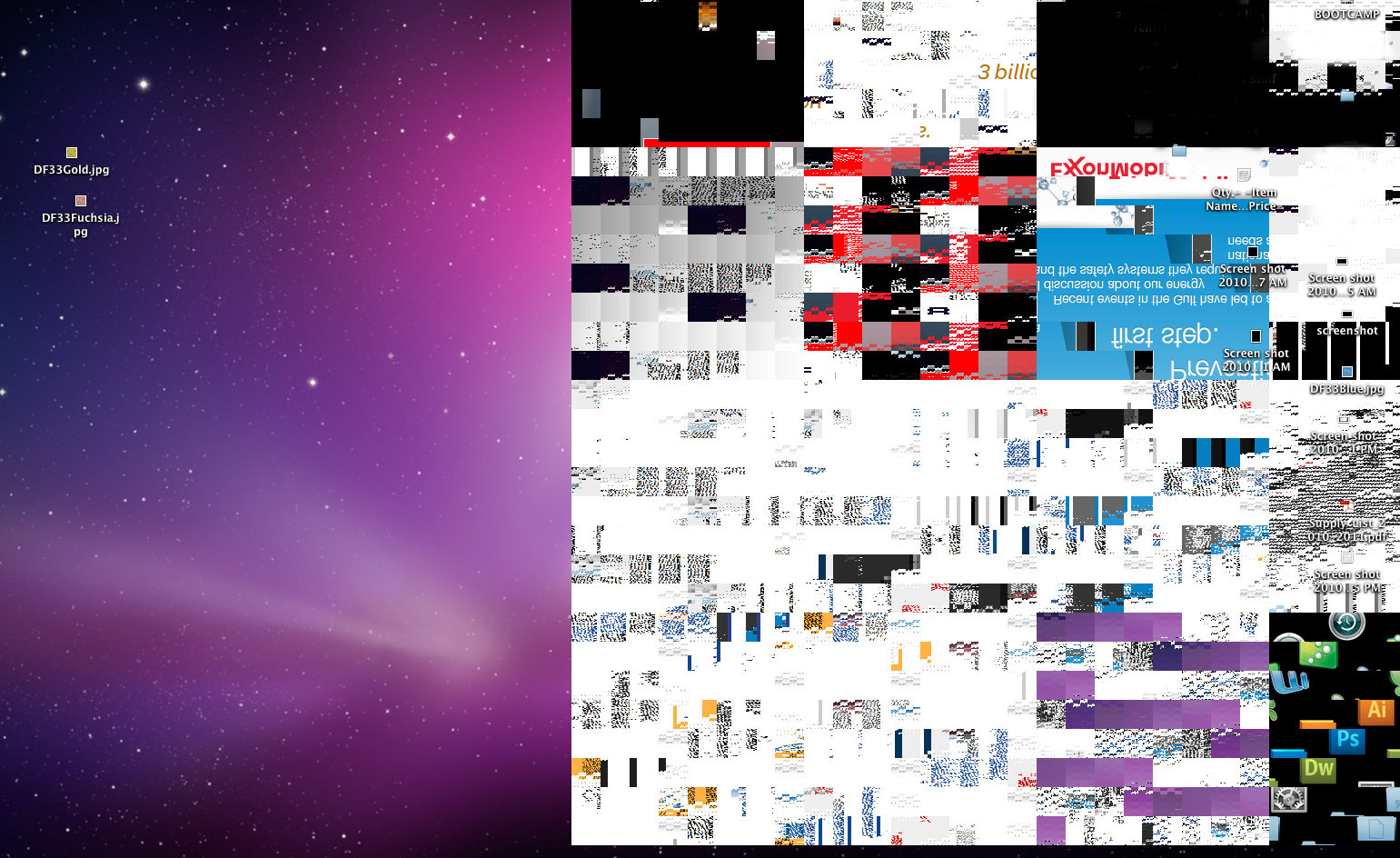

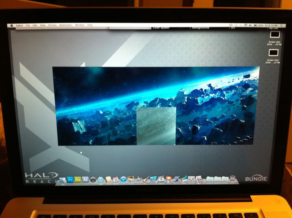

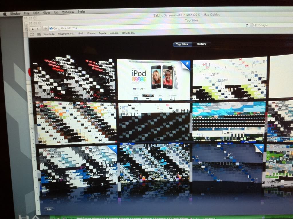

Well I will let the pictures do the talking.
The first picture is my desktop. I currently have my wallpaper set up to change every 10 min. There are 3 pictures that rotate and as you see in the first picture, they are merging together...
The second picture just shows some weird 5h*t. This happens almost every where. It happens a lot in YouTube.
I have a MacBook pro i7 (2010). It's only 1 month old and this has been happening for like 2 weeks but it does not happen everyday. More like every 2-3 days. I have to restart my computer to fix.
Should I be concerned?

It is more likely a hardware issue than software... Artifacting doesn't necessarily happen across the entire screen, and a restart will often fix it. In fact, if it happens sporatically and a restart fixes it, a software issue is very unlikely.

My i5 MBP started doing that recently too. Like you posted, it happens every couple days. Then when it happens it happens a couple times on different pages, and then just stops by itself. I, too, am wondering what to do and suspect I should take it in-for this and other issues.

Yes, the screenshots dont work. Thats why I had to take a picture with my phone. You pretty much have the same thing as me :(

I've had the bottom pic happen to me a couple of times--happened just the other day--opening up a new finder window had all of those interesting designs in it. Restart brought everything back to normal. :)

I'd be taking it in and getting it replaced under warranty - looks like a hardware issue.

I've had this problem as well. I think it's related to poor drivers for the Intel integrated graphics card.
I've found if I use gfxCardStatus to switch to the NVIDIA card when the problem happens, everything is fine again (without a restart).
Same here, I get the same issue that's in the second screen shot and it only happens when I'm running off the Intel IGP. As soon as I set it to Nvidia like yourself it's perfectly normal.

Finally got a screenshot with Grab. I took it to Apple today and the geniuses never saw the problem before. They thought I need a new logic board. So, they ordered one and we shall see what happens!
