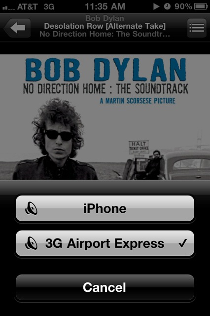

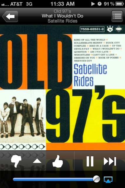

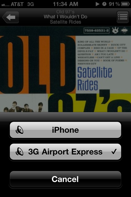

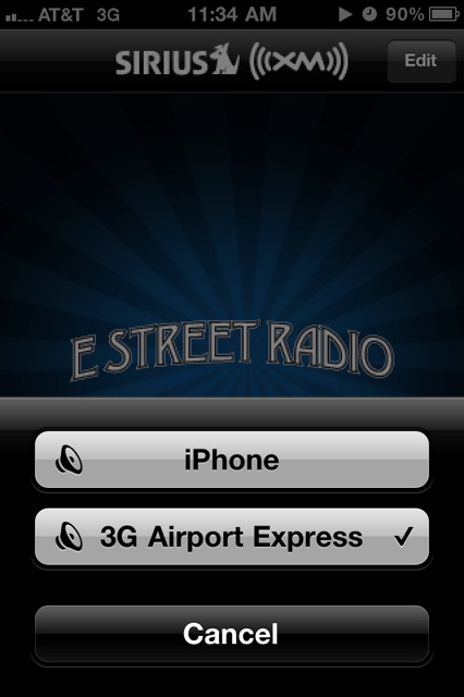

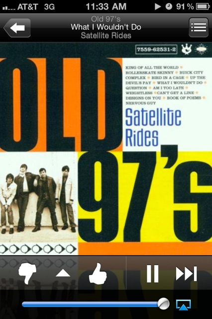

Got this to work perfectly. I can stream from 3g all day and airplay to my airport with out having the internet plugged into it. Pandora, Sirius radio and ipod all work great. you can see it is still connected to 3g even after i turn wifi on and connect to the airport. Can stream to airplay and surf the web and receive all my e mails. All i did was plug in the ethernet cable into the airport and created a new network on the airport. then when you unplug the ethernet cable so there is no internet connection it still lets you connect to the wifi network you created but it can't pull internet because there isn't any plugged into it it continues to pull everything from 3g.
