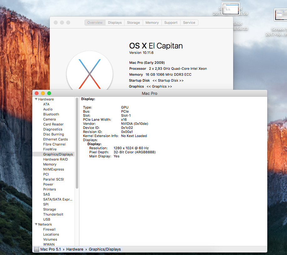

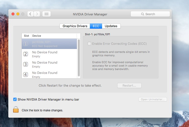

I've done the steps from this post, triple checked, that the Nvidia drivers are set, and I end up having a black screen with no video output whatsoever after restart. Via screen sharing I see that the display is recognized as "pci10de, 10f1" in the Nvidia driver manager. The system information shows that the display resolution is at 1280 x 1024 and no further information. Although, "No Kext Loaded" is somewhat disturbing.

If you look closely through the Macvidcards driver guide you'll see that Pascal cards (GTX 10xx series) require 10.12.4 or newer macOS.
Hope you don't have some software that won't work with Sierra, because that's the only way for you to use your GPU.
