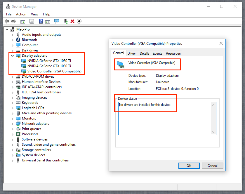

Persistence pays off !!! It's all working now. After banging my head on my desk for a week swearing at Windows I finally got everything working together and can button up my machine.
This was the solution: When windows initially see's the GT120 card it identifies it as a VGA Compatible Video Controller. At this point everything is okay. But within seconds of booting to the desktop it attempts to install drivers for it and that's what brings down all three cards. I was finally able to get windows to STOP installing drivers automatically. The card stays as a basic VGA Video Controller with no drivers installed or required. With no driver conflicts the 1080's are working awesome.
Thanks to everyone for your suggestions. I can finally get back to work while I still have a little hair left.

This is what finally worked to stop windows from installing the drivers. I used both Method 1 and Method 2 from this article.
https://www.drivereasy.com/knowledge/stop-windows-update-installing-drivers-in-windows-10-solved/
