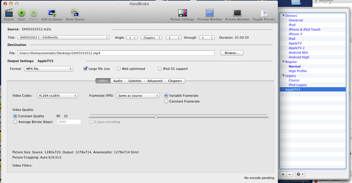

So I am a bit anal and want to be sure I got this right, is this what the settings should be?
Also, if you have a source file that is 720p, should you just use the Apple TV Settings?

Can't really tell your setting from that image but here is what I did:
High Profile (that sets all of your video parameters: RF, framerate, etc)
Large file
Web optimization (improves streaming ability)
Strict anamorphic
Detelicine: off
Decomb: default
Audio
1st track AAC Prologic II
2nd track AC3 Passthrough
That will work with both 1080, 720 and 480p.

Thanks! I think that is how it is set, I just like to double check!
Appreciate your response 🙂

STOP!!!!!!!
You have RF=32(!) in your screenshot - that is going to look like ******. The High Profile preset defaults to 20, I'm running 19. Some folks go to 22 (larger numbers are more compression, lower video quality). 32 will be unacceptable.
STOP!!!!!!!
THANK YOU!!! Had no clue what that meant 🙂
