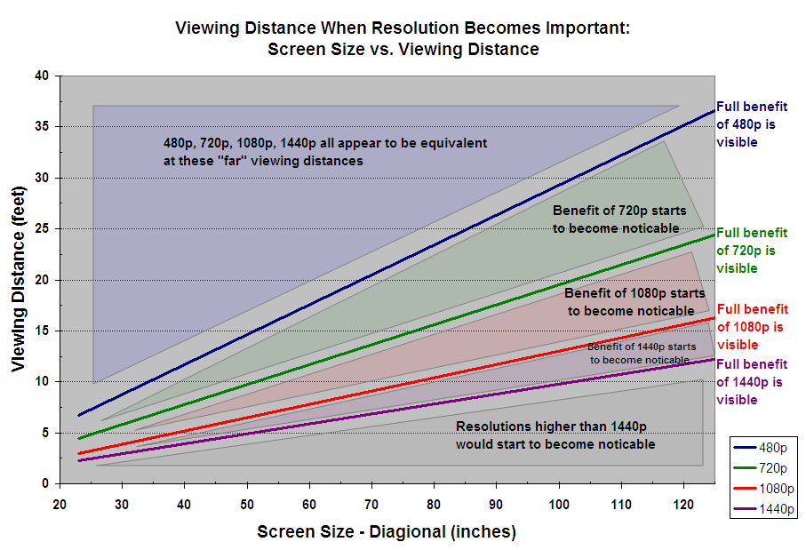

I am getting a Master's Degree in Optical Science from the University of Arizona. I was recently shopping for a new TV and I was faced with a choice that most of you have faced or will face when shopping for a new HDTV: should I save some dough and get a 720p TV, or is the additional cost worth it for a 1080p TV? I am going to present a purely quantitative and scientific way for determining if a 1080p TV is worth it. In fact, below I will list an equation that will tell you once and for all which one you should purchase.
In order to understand the equation, you must understand the following concepts. The 20/20 human eye has a maximum visual acuity of 1 arcminute. That is, two points must subtend an angle greater than 1 arcminute in order for a 20/20 eye to resolve the two points. What this means for TVs is that pixels on a TV must have an angular subtense of 1 arcminute or greater in order for your eye to resolve the detail in the video.
In order to determine the angular subtense of one full pixel (red+green+blue) of a 16:9 television, just use the following two expressions:
To determine the angular subtense in arcminutes for a 720p TV, use 60*arctan(a*0.00005319553/b) where a is the diagonal size of the television in inches and b is the distance you will sit away from the TV in feet. (One caveat: this equation actually assumes 768p TV since this is the actual native resolution for most TVs). Also note that these expressions are in degrees, not radians.
Example: Let's say that I wanted to find the full pixel angular subtense of a "720p" 42-inch LCD and I plan on sitting 7 feet away from the TV. The angle subtended by each full pixel is 1.1 arcminute. This represents a condition that borders on the very edge of the maximum detail that the 20/20 human eye is capable of resolving.
To determine the angular subtense in arcminutes for a 1080p TV, use 60* arctan(a*0.00037827932/b).
Example: Same situation: 42-inch TV, plan on sitting 7 feet away, but this time the TV is 1080p. We find that the full pixel angular subtense is 0.7 arcminutes. This represents a situation where the TV's video resolution is beyond the absolute resolution limits of human vision.
In the example problem provided, spending additional money on a 1080p television is like throwing money down the garbage. Your eye is not capable of resolving the additional video resolution of the 1080p TV in this situation.
Point of interest: although 20/20 vision is often considered "perfect", it is theoretically possible to have 20/6 vision. In order to get this vision, your eye anatomy must be perfect, and your pupil size must be about 4mm. Any larger, and the visual field is dominated by aberrations. Any smaller, and the visual field is diffraction limited with an ever increasing airy disk diameter. In this perfect situation with perfect field irradiance, the maximum resolution of this eye would be 0.4 arcminute. Note that very few people in the world have demonstrated uncorrected 20/6 vision.
I have a 120" 720p front projection DLP system and sit 15 feet away from it. I cannot see any pixel structure whatsoever. I have been convinced for some time that 1080p is too much for any TV you might actually want to buy. I know people talk about a 50" set being the upper limit for 720p but in my experience even 60" from 7 feet is still going to be too small to justify 1080p.

Regarding display sizes: For 720p the maximum display size I recommend is 55 inches. for 1080 the maximum size I have calculated is 103 inches. BUT full HD spectral resolution must be there to have the right experience. (Those sizes are calculated at 21 dpi for 2~3 mts viewing)
Is this to say that a 1080p television will display an image with the same effective resolution as a real object placed next to it (from a distance)? I find this hard to comprehend.
I can believe it. A good television with great source material from a decent distance produces very very sharp images, but of course the process of an emissive television cannot come even close to competing with the contrast ratio you will get from a real object in front of you, and there is no depth perception in play.

I read your post, and I thought that was interesting about the different eye quality... I myself have 20/15 or 15/20... whichever is better than 20/20) and I didn't think that I couldn't distinguish quality that much better, but I guess that I can at least a little bit based on the conclusion I came up with.
I have a 40" Samsung 1080p LCD TV, and I can't say that I entirely need all of the pixels, but I gotta admit that the quality really stands out when it comes to games, and Blu-Ray Disks. My friend had a 42" 720p LCD, and after comparing them we concluded that the 1080p makes a big difference for gaming and BRD. On games like Call of Duty 4, everything looks more realistic at 1080p. This doesn't mean that 720p is bad, but as everything slowly begins to support 1080p, I think it is worth it to spend the few hundred dollars extra. But keep in mind that this is ~8 ft viewing range. (My TV only cost $1600 new off Amazon)
Just because a difference is clearly discernible does not mean that the difference is significant.
For instance, If I'm doing great in a college class and I only need to get a 50% on my final exam in order to receive an A+ grade in the class, then even though I can clearly discern whether I got a 50 or a 100 on my final exam, the difference is not significant, because both achieve the same goal equally. It's the same with some people's opinion on HD.
To me, and many others, we can clearly see that HD is sharper than SD, but seeing that extra detail doesn't make us more entertained.

While this is a partially true argument for recorded video content. It does not hold up for real-time content like text or gaming. The problem is the margin of error on rendered material leads to artifacts like the aliased jagged edged on diagonal lines. A 1080P realtime source is significantly smoother than a 720P source. Basically the extra resolution allows your eyes to carry some of the load by averaging out the errors.
But even for video, your own calculation show that 720P is lower quality then what your eye can see while 1080P is better then you can see. The math of your example reinforces that 1080P is visibly better then 720P on a 42" screen at 7'. (720P<Perfect<1080P)

To the threadstarter, remember that distance from the source is equally important. Screen size, resolution, distance from source are all equally important. This chart convinced me to save $1000 and get the 720P Panasonic TH-50PX75U instead of the 1080P Panasonic TH-50PZ700U. With a 50 inch screen, and sitting 10 feet away, it is apparently 'impossible' for me to see any difference at all.
I've got a 1080p 46" screen and my normal viewing distance is 10 feet. Its true, I can't really tell any difference between 720p and 1080p content at this distance. Sometimes when I want a real HD experience, I'll sit on the floor about 5 feet away from the TV and here I can definitely tell the difference. Considering 1080p TVs don't seem to cost much more than 720p ones these days, I'd always go for 1080p. Sure you won't tell the difference in most viewing conditions but if you *do* ever sit nearer, you will notice.

My point was just that the math shows that 1080 is better at on a 42" display at 7'. You don't need to get 'full benefit' from 1080 for it to be better. Your conditions only need to exceed the 'full benefit' of 720.
If he is going to use math to prove a point, his numbers need to be bare that result.
