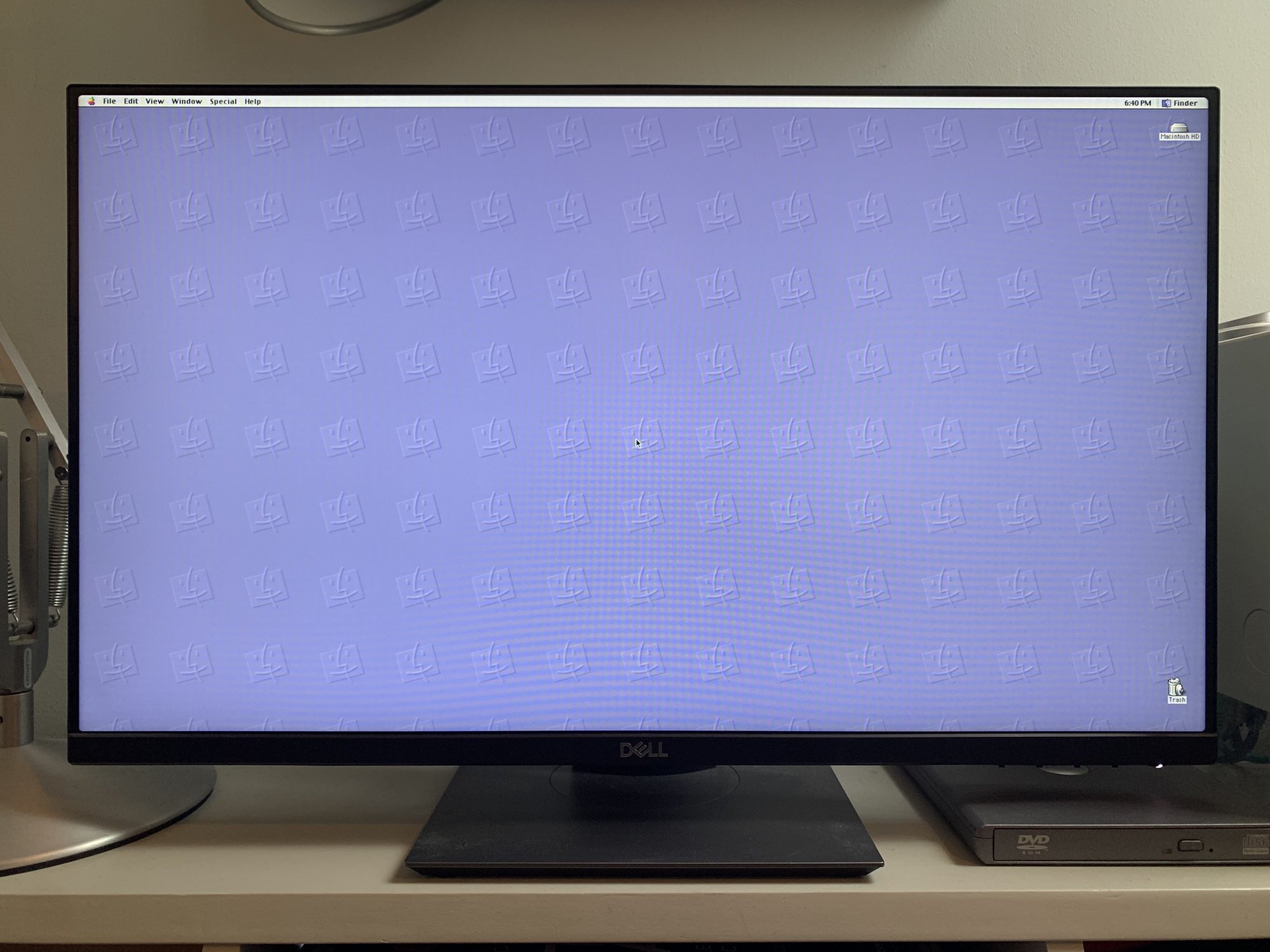

Thanks for the replies so far. I agree the video card is not the best, but it runs OS X 10.4 just fine at 1080p. It also runs OS 9 fine at 1080p if I boot holding shift to disable extensions, see below. But I'm in a bit of a catch 22 as it won't display anything with extensions enabled, and when they are disabled you can't change the monitor settings! 😆
So what else can I try? Somebody on another forum mentioned moving monitor preferences to the desktop and then booting, but I couldn't find a preference called 'Monitors' in the preferences folder, and I expect I then won't be able to change the settings anyway.
