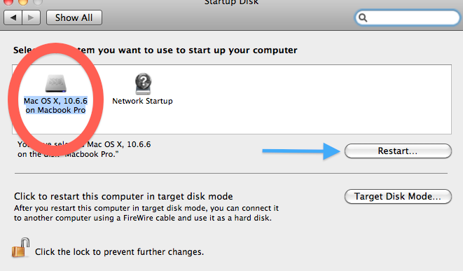

it cant find the os, boot with option don, and select the startup disk in system prefs.
In system preferences click on Startup Disc. Then select your Mac OSX disc. Then click restart.

I put the disk in and held down the option key while turning the mac on. I can pull up a disk utility window but there is no option for system pref. Am I doing something wrong?
Choose Startup Disk from the Utilities menu.
If that doesn't work, open Disk Utility and see whether the hard drive appears in the left column.
If I don't put the disk in and I hold down "option" while restarting, nothing happens. I get a white screen. If I put the OS disk in, I get the screen to install OSX. From there, I can navigate to "disk utility".
Ok, I have the window up that shows what ECU had posted (the pic), however, it's showing OSX DVD, not the same thing as what's in the pic. I'm assuming that's because I have the disk in (which is the only way I got to that screen to begin with).
