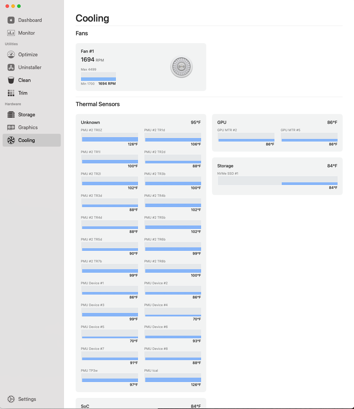

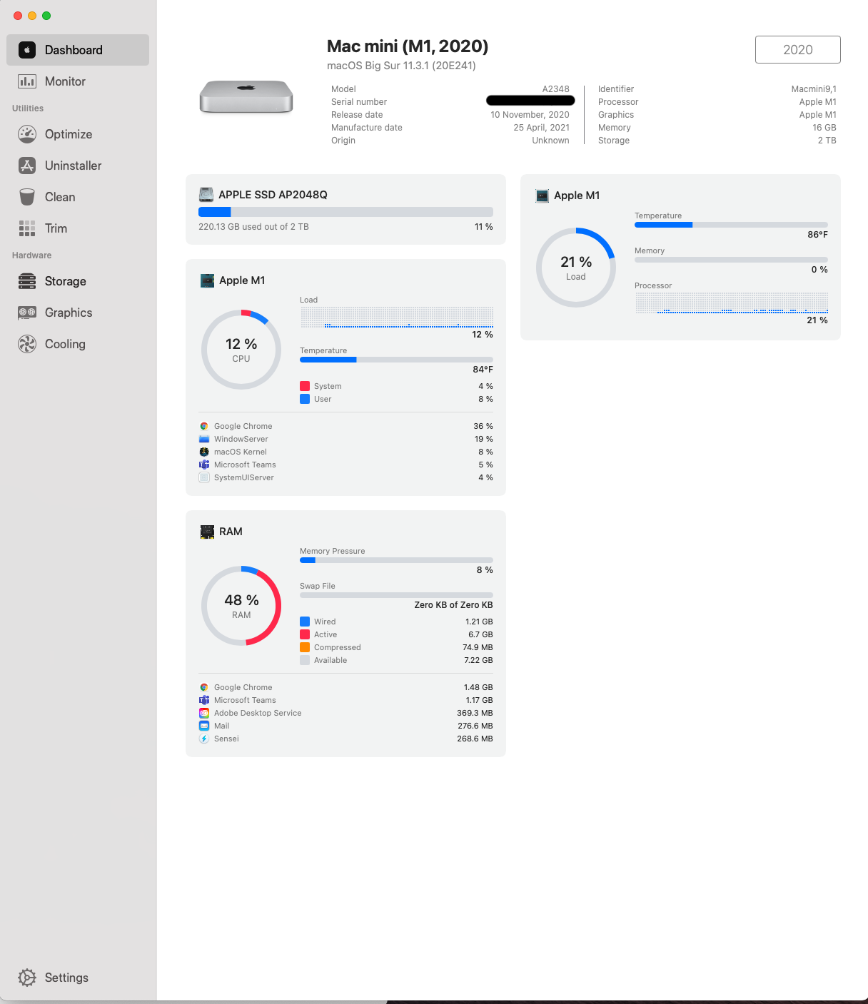

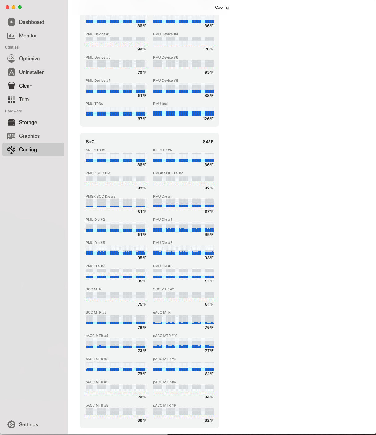

What is the NIC listed under? These are the temperatures I have:

It's from Apple. I have a SonnetTech 10G SFP+ adapter as well, but I'm not running it on the Mini. I'm using the built-in 10G ethernet via CAT6a.
Reactions: FrancoisC
I don't have any recent minis, but on my 2012 the closest sensor readings are Thunderbolt proximity or Platform Controller Hub. So if even on an Intel mini there wasn't a NIC specific sensor then can we assume there isn't one for the M1 as well? (can anyone confirm the sensor items on a recent Intel mini)
The chipset probably isn't underneath the M1 SoC package / fan chamber, just lying around on the rest of the logic board where there is less airflow. It is a legitimate question to see if prolonged high usage of the NIC would build up heat enough to degrade performance.
thank you! I was hoping that the NIC would be listed specifically. maybe the utilities have to be updated to recognize the temperature of the NIC, I don't know... what happens I you read the temperatures after several minutes of full load on the network interface? it's possible that one of the temps goes up, then we would know which sensor refers to the NIC.

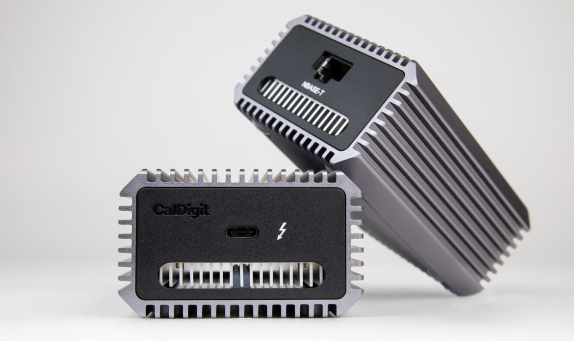

I have a CalDigit 10G that is about twice as thick as the Sonnet, they are both passively cooled and uses the same AQC107. Mine almost never fails, the surface of the heatsink is constantly hot to touch (44 degree C according to my IR sensor). I have a feeling Caldigit decided to make it this thick has a lot to do with lack of heat dispersion efficiency in other makers' models.
