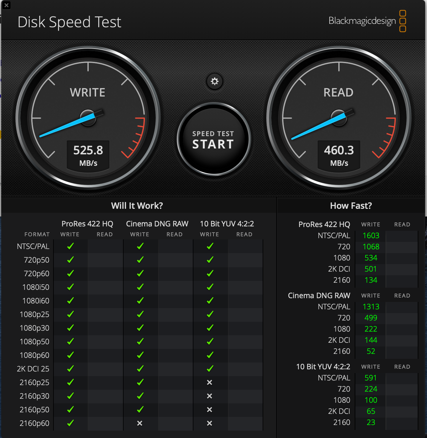

I have a FS1018 with 12 x Crucial 2TB SSDs in it. I am using the 10Gb Ubiquity Edgeswitch and the fastest WRITE speed I see is 525MB/s and READ speed is 460MB/s. I am using the Blackmagicdesign Disk Speed Test utility on the Mac Pro.
The volume is using Btrfs in RAID F1. I do see that the volume utilization hits 100% when the tests are running.

What speeds are you seeing on the Synology FS1018?
Seems you have only 5Gbit speed, it easy get close 1 GByte/s write and close read.
525MByte is 5Mbit/s not bad if you have a switch limiting bandwidth, try bto get it working full duplex
Check your network, also use SMB instead AFP not ftp, the faster is to use lun, but it requires a special driver at the Mac side as long I remember.
Thanks for the suggestion. That test was with SMB. I tried AFP and the results were similar. I will try connecting the Mac Pro directly into the FS1018 to see what numbers I get.
In regards to the utilization of the disk being at 100%, wouldn't that be a bottleneck?

I don't think it's an Nas bottleneck, almost 100% it's an switch/cabling issue, check you're working at 10G full duplex all the way Nas-switch-mac, also check your switch management options maybe there's something there causing the bottleneck, this Nas is rated at 1GByte write and 2GB read , using 12sata SSD (500MBñs each) bring enough I/O headroom, an issue related to trim command shouldn't cause that peculiar bottleneck.
i think copper will punk out around 40gbe So to me the cat 8 is worth it.
I suspect you're right regarding copper. It'll be interesting to see what happens to the "consumer level" NICs over the coming years. Will we start seeing affordable 40GE? Or will the market just not bother, and instead leave consumers at 10GE?
I tried using iperf3 client on the Mac Pro while running the iperf3 container on the FS1018 and saw 10Gb speeds. There may have also been some network congestion occurring during the time I ran the previous tests. Happy to see the results below. Thanks for your input!
