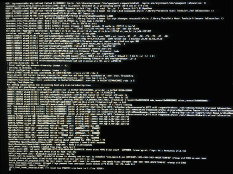

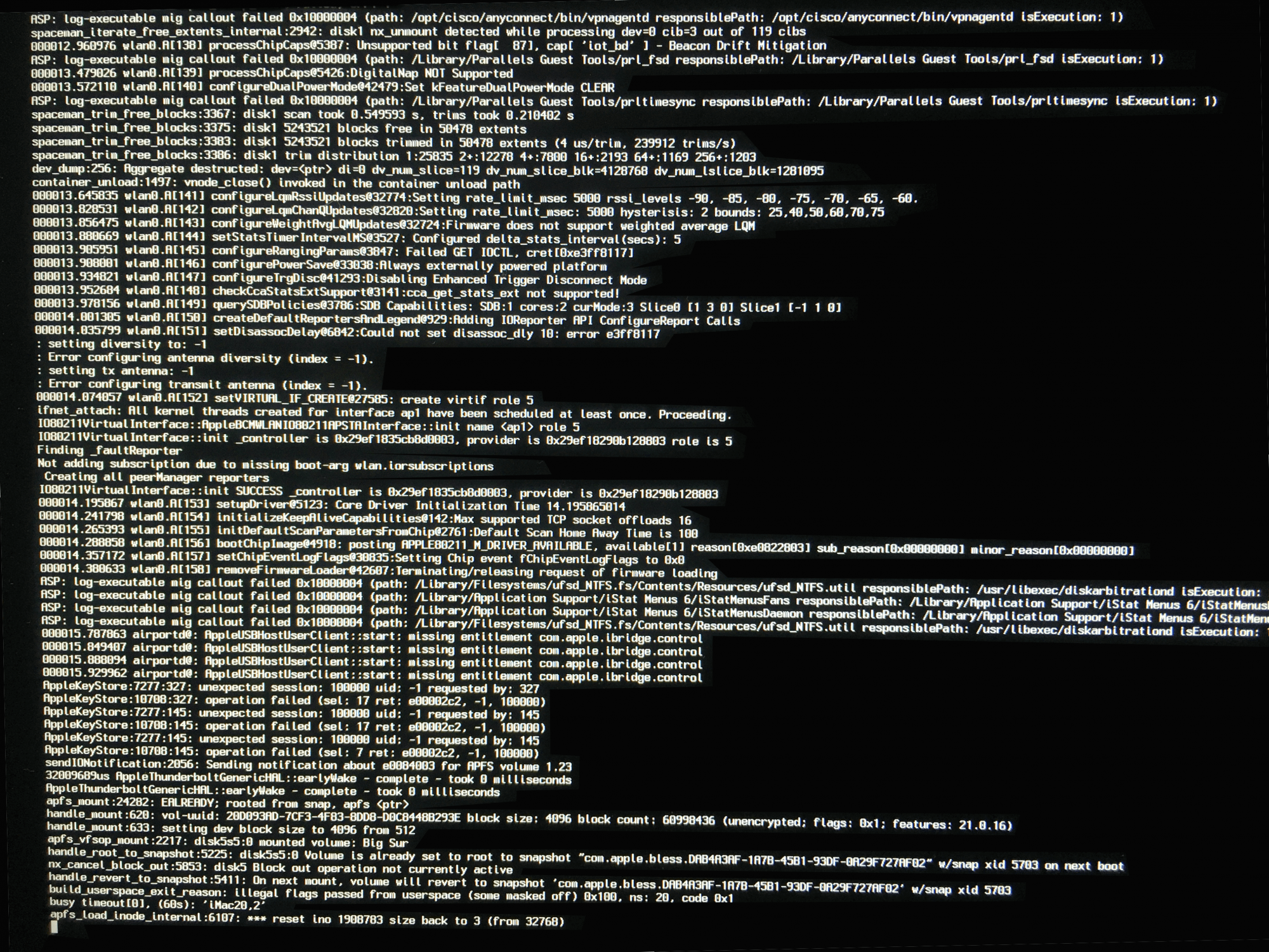

  • Totally at random, the T3 drive would stop booting. It would load about half way at the Apple logo, hang, and crash. Booting into verbose mode, it looks like it's hitting a watchdog timeout with com.apple.remoted.

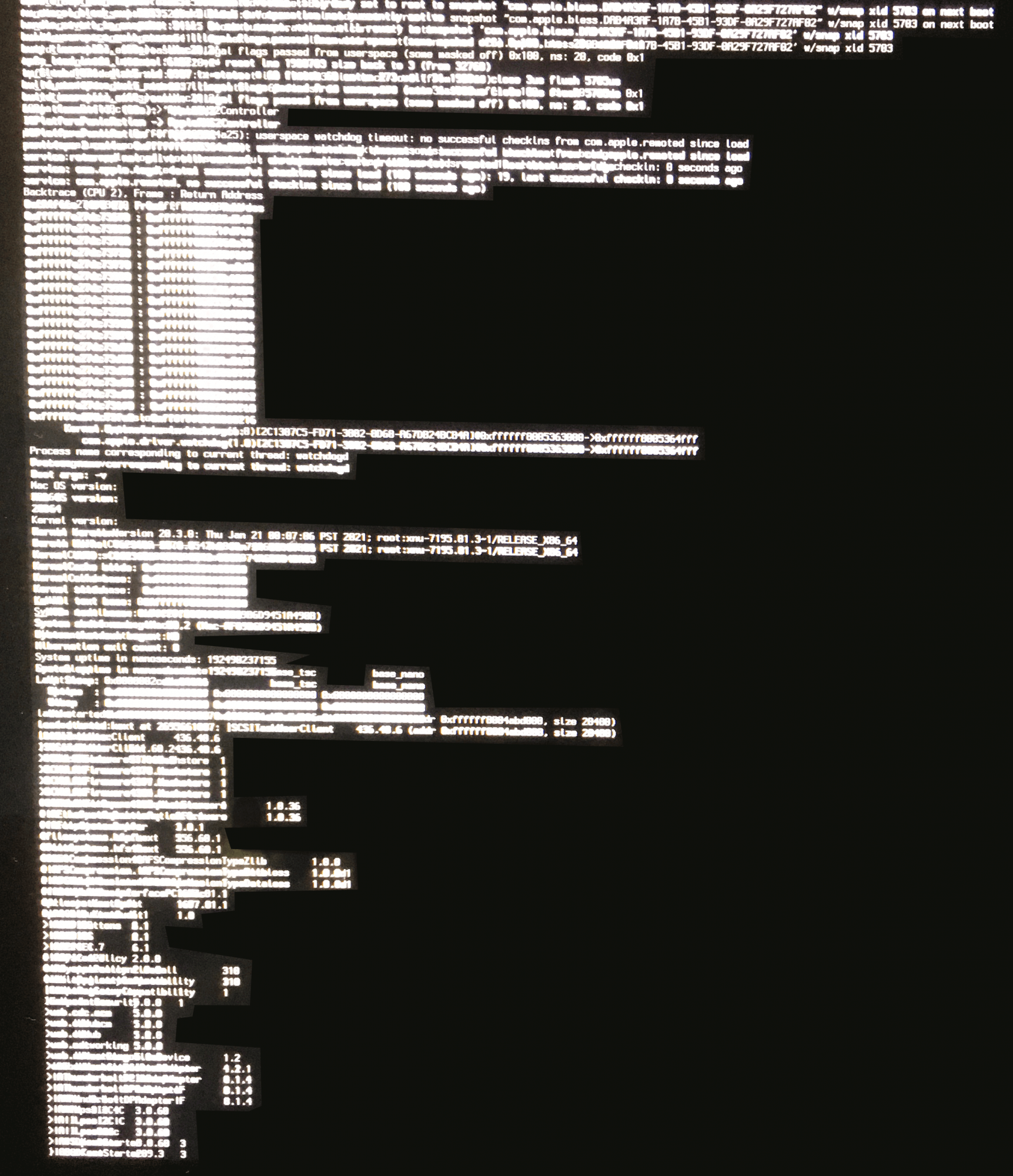

I'm attaching screenshots of the T3 drive failing to boot and the kernel panic log that got dumped after I booted back to Catalina. I don't personally see anything too interesting. Also my apologies for how blurry the 2nd screenshot is -- my phone's camera couldn't keep up well with the rate the text was being printed.
