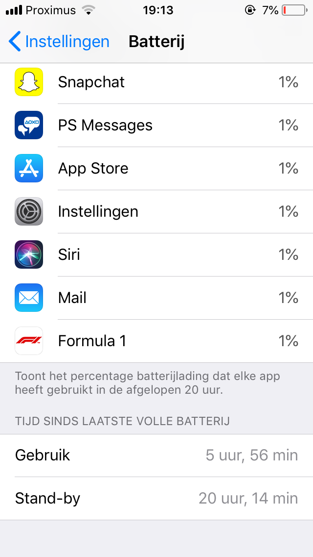

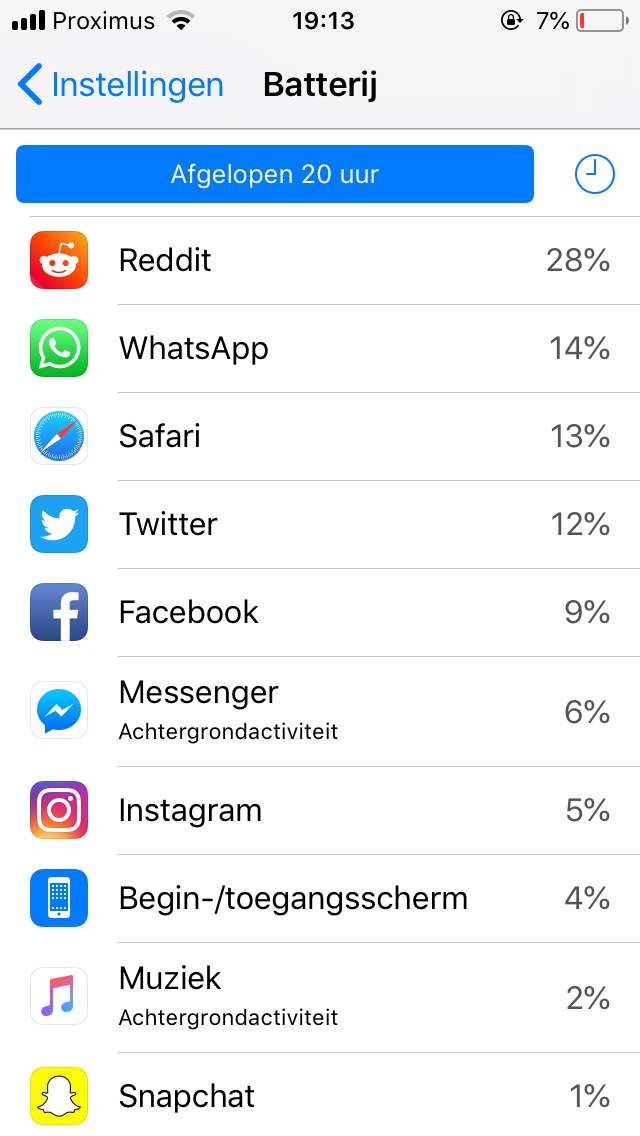

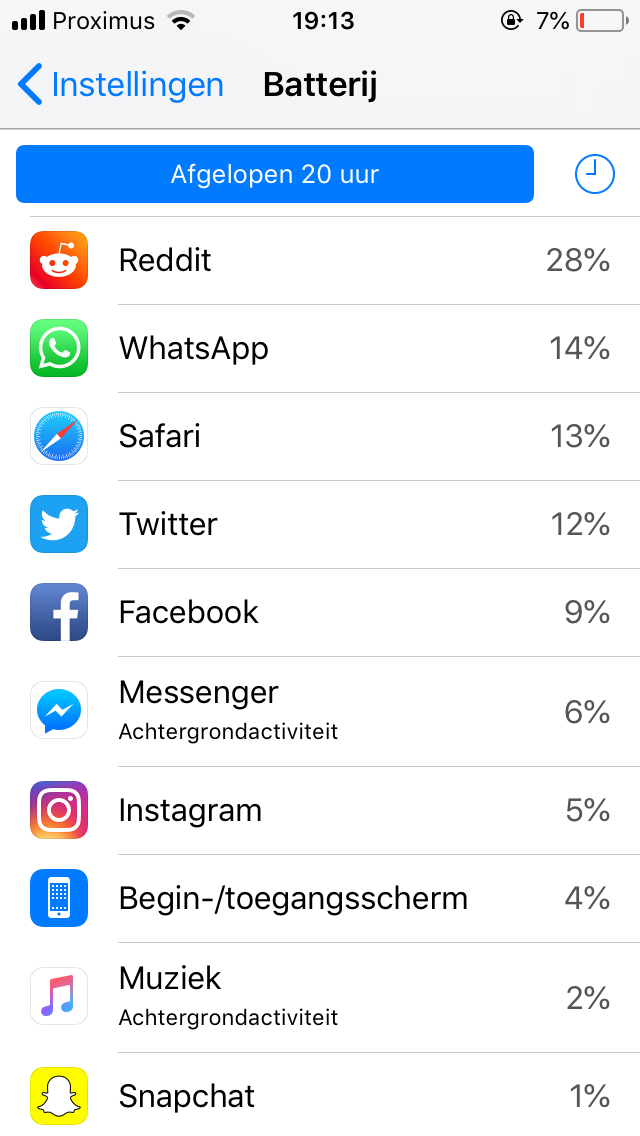

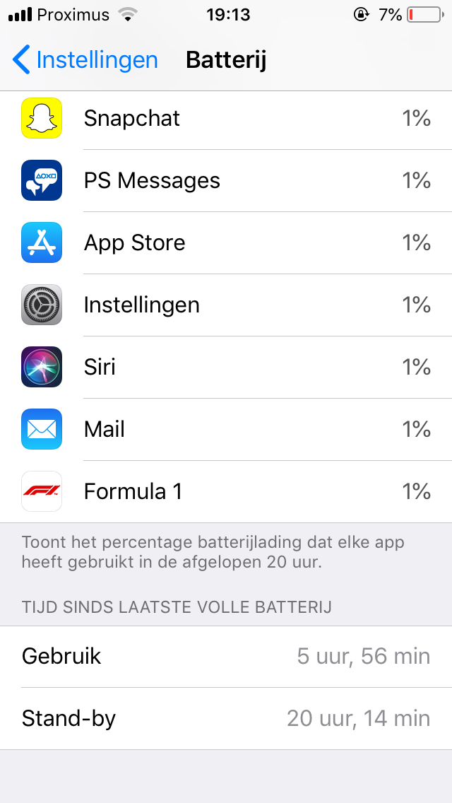

So results of today. Got taken of the charger before it went to sleep (put in Airplane mode). Used throughout the day without any 5GHz Wi-Fi networks, without any charging or Low Power Mode, happy with the results for an iPhone SE.
