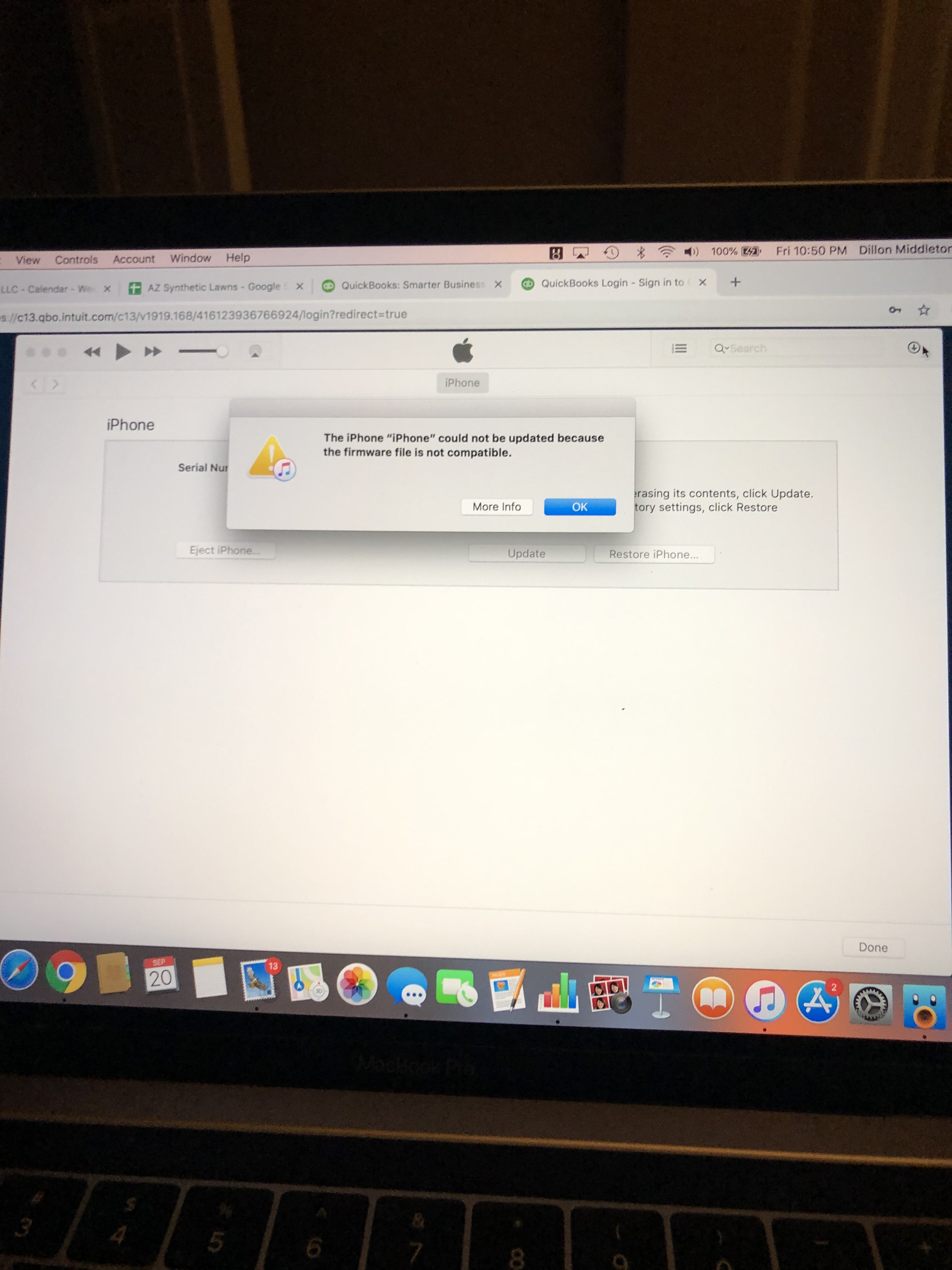

I really don’t know what to do at this point. The 4.31 GB downloads then I get this error message
