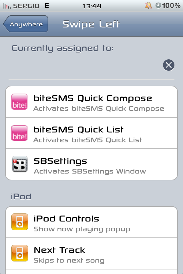

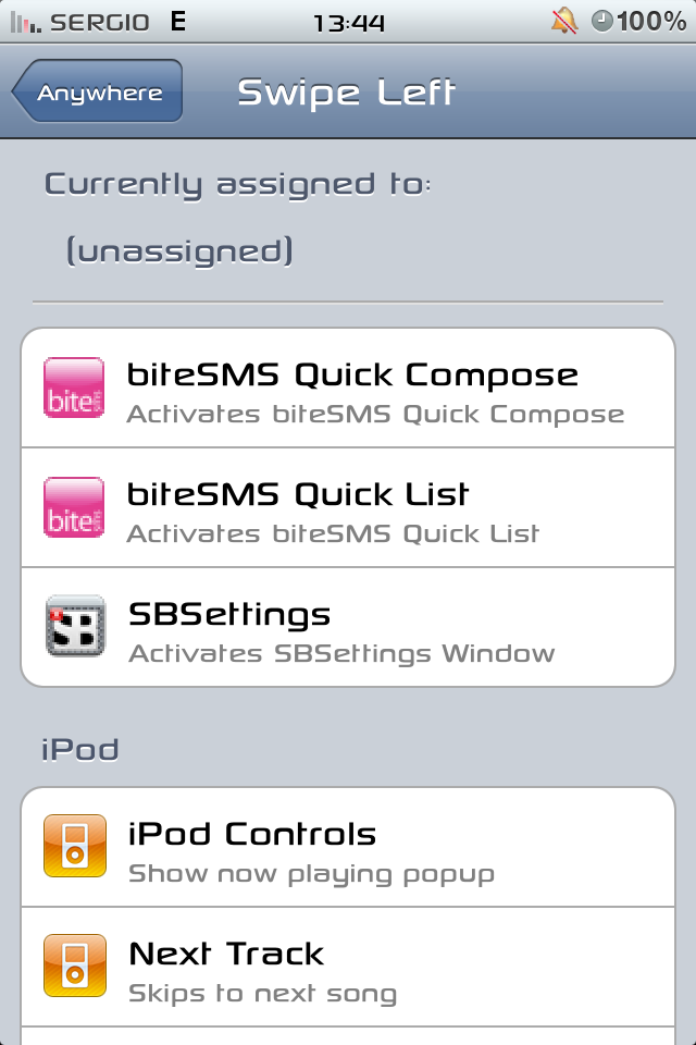

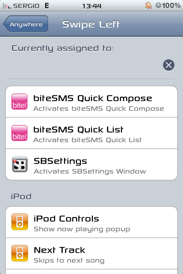

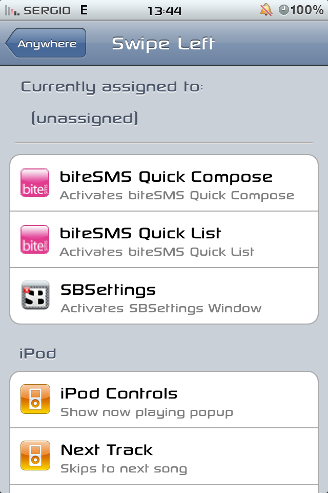

So, I thought that the problem was with the Activator settings. I had something like this assigned to the Home button, short press:
It should, of course, show the name of the program or nothing:
But that did not fix the problem...

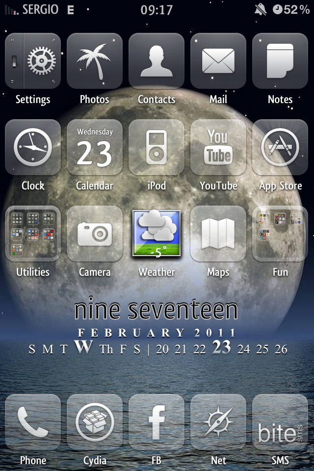

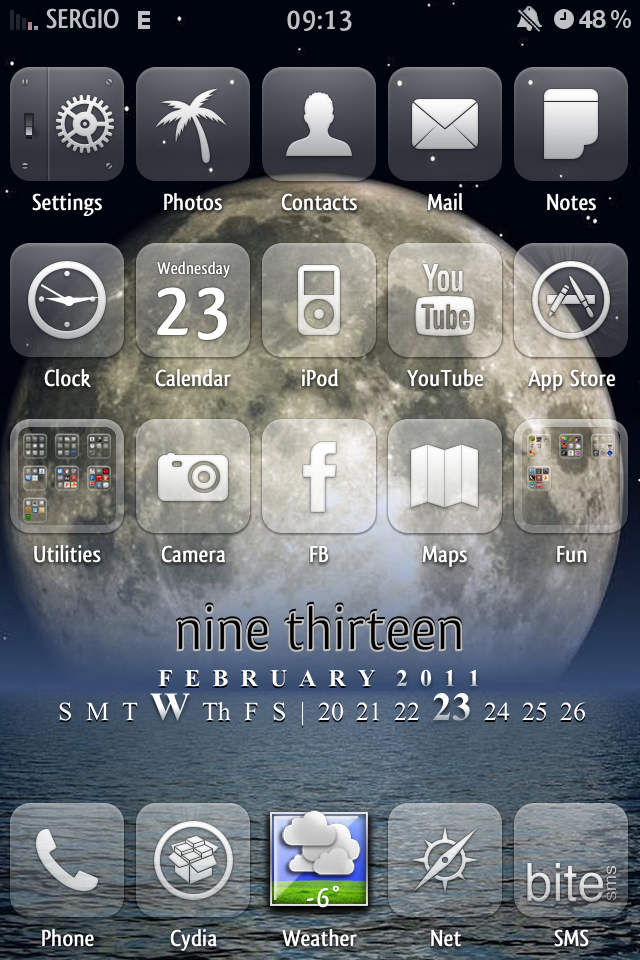

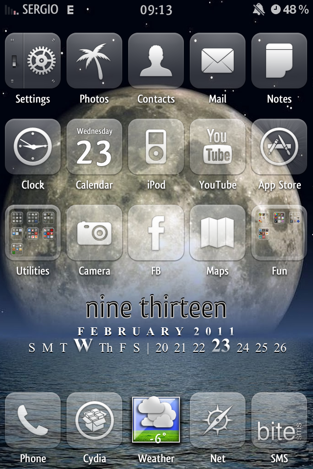

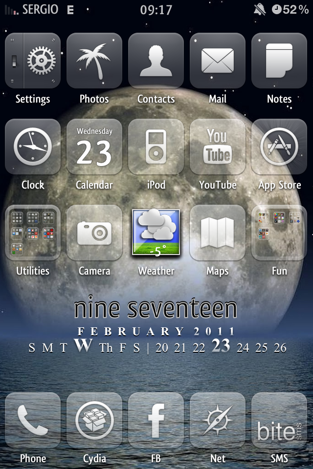

While on my way to work, I saw that the Weather icon, which has WeatherIcon installed, was showing -6 Celsius. I found it strange, because it didn't feel that cold. So, I open the weather to double check and also to try and refresh the weather information in the icon. And as soon as I closed the app, the phone crashed!
That's when I remembered that last Sunday I downloaded and applied a widget from LEX (this woman is amazing!). And in order to have full visibility, I moved some icons around the SpringBoard and placed the Weather icon in the dock. Moving the icon back to the Springboard fixed the issue!!!
Don't you hate it when such simple things cause so many problems? :D
I'll send an email to the developer for him to check. Here's some screenshots:
BEFORE
AFTER
HURRAY!!!!!
