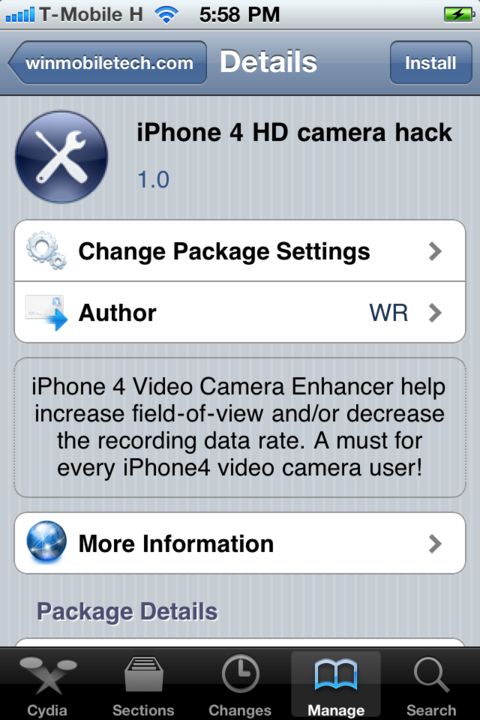

During jailbreaking, make sure you install Cydia. After the jailbreak is ready, start Cydia and select any of the three possibilities (Developer will be just fine). Then, add “http://www.winmobiletech.com/cy” or “http://winmobiletech.com/cy” as a Cydia repository source (currently, it's the repository that has my package) and, inside it, select the iPhone 4 camera enhancer:
Install it and start after making sure you've killed the Camera app. If you don't do the latter, the changes won't be visible in the app.

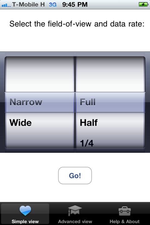

After starting, you'll be greeted by the following screen:

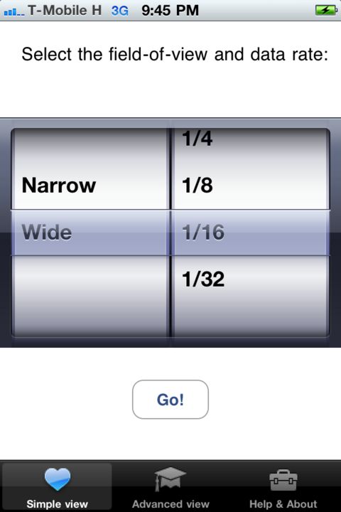

Here, you only have two columns in the picker to (independently) select your field-of-view and data rate. Feel free to make a selection. For example, if you want to set the field-of-view to wide and the data rate to 1/16th of the original, make the following changes:
Now, tap the Go button to commit the changes.

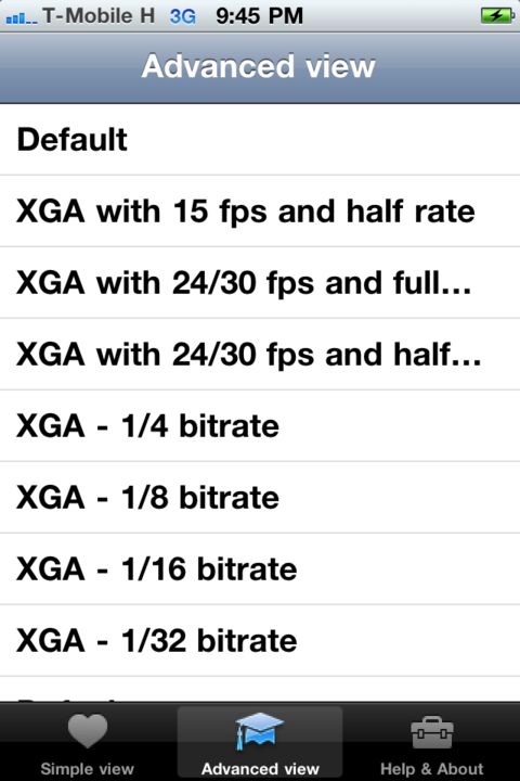

If you want to fine-tune more parameters (not only the data rate and the one-step switch between wide and near field-of-view), you can do this under the second tab, “Advanced view”. In general, I don't think you'll ever need this; however, I still provide you with it, should you really want to play with these parameters. At first run, it presents a default settings list without a checkmark:
Each element of a list corresponds to a given configuration setting. For example, if you want to use (or fine-tune) the parameters of, say, “wide” view angle (corresponding to XGA output video resolution) and quarter data rate, select the “XGA – 1/4 bit rate” option.

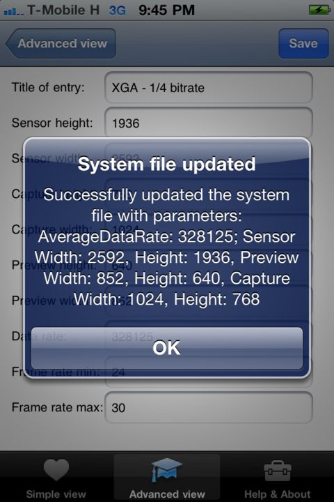

In the detailed view, make your changes (if any) and, then, tap the “Save” button in the upper right corner. You'll be shown an acknowledgement dialog telling you the changes are written back to the system:

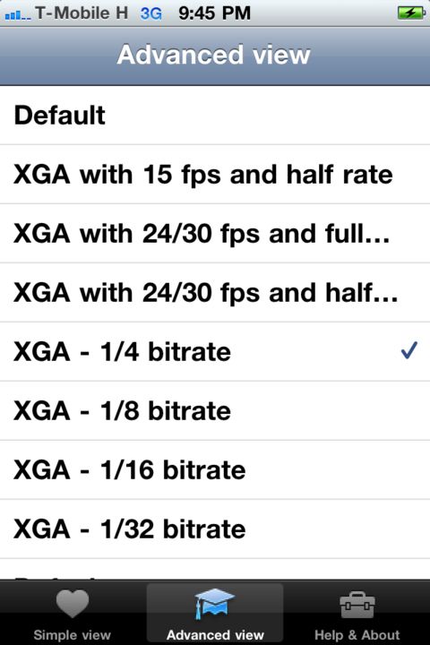

After this, in the main selection list, the just-edited (or just saved) entry will have a checkmark next to it (after restarting the app too):

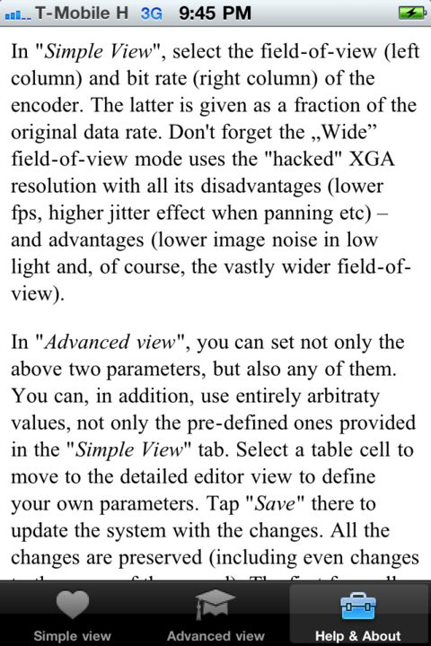

Finally, the last tab is just a quick explanation:
