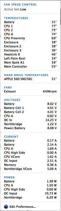

Mine is running between 72-77 C while using a mini display port to HDMI connector.
I have a 2011 i7 11" as well.
