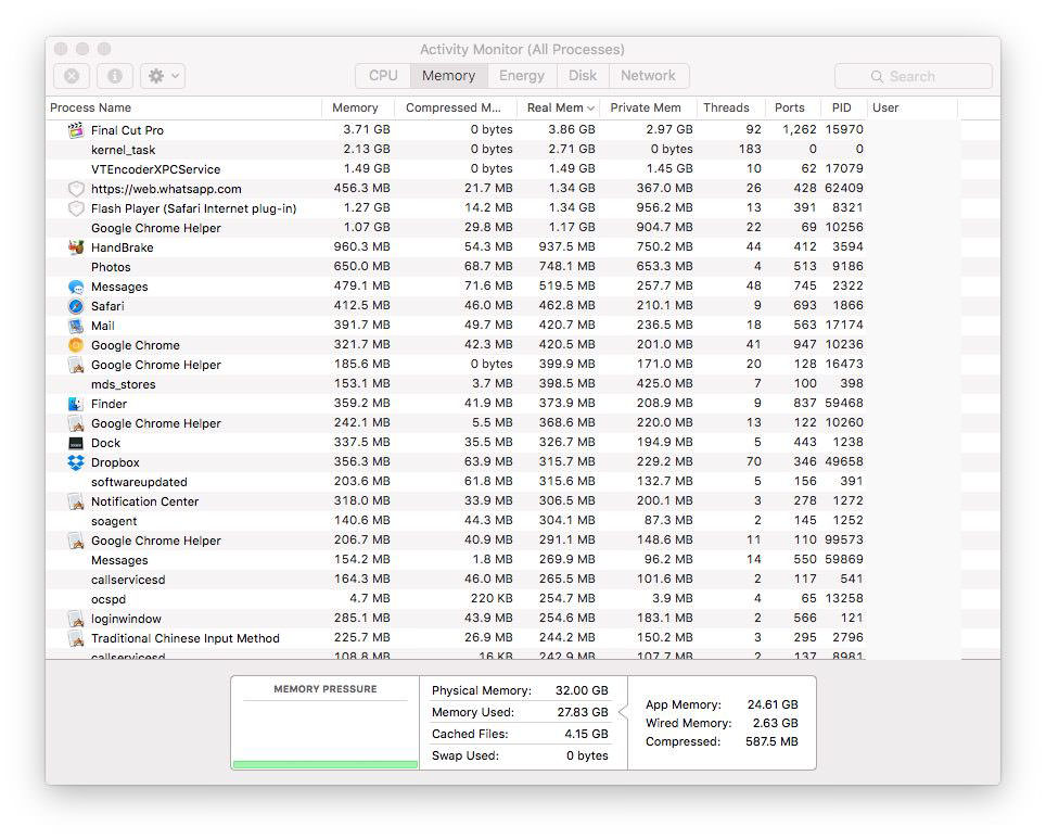

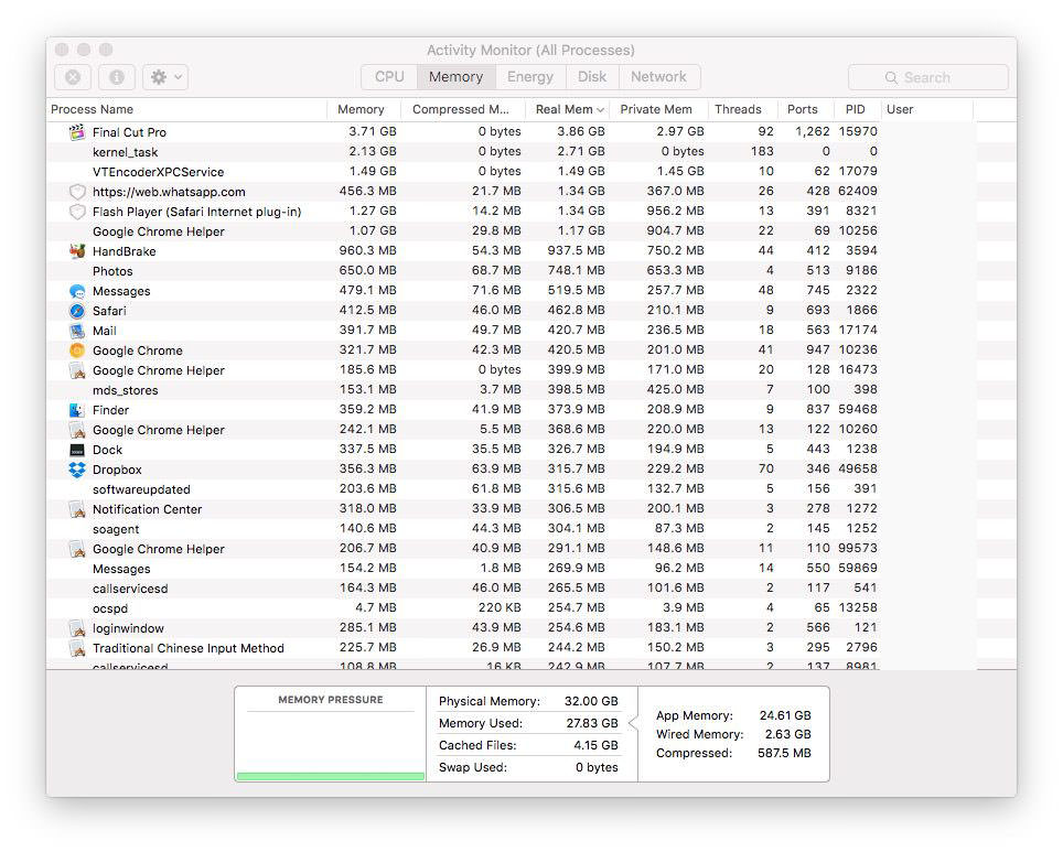

I rarely see the system running out of RAM. However, when using FCP X, my Mac can actually use all the remaining RAM as cache. The more I have, the more it can use.
When I have 32G RAM, it use the remaining RAM as cache, and in fact, compress it a bit.

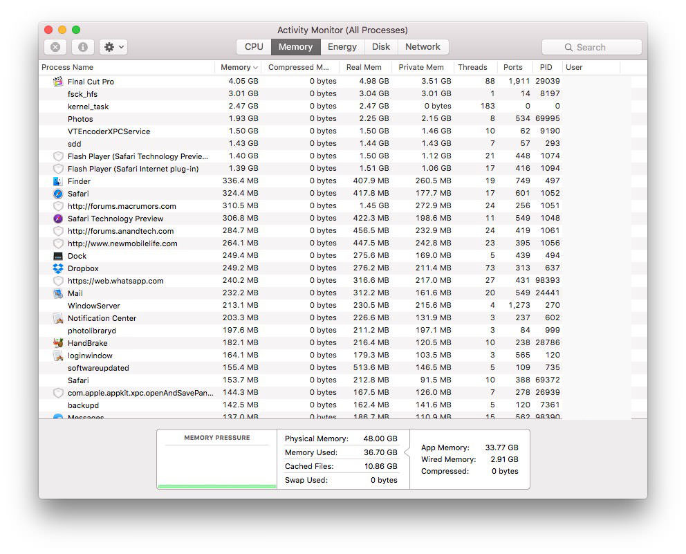

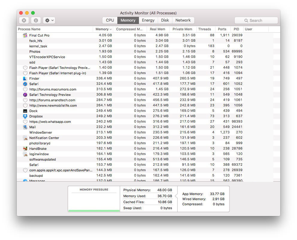

When I have 48G of RAM, it can go further, and still able to use all the remaining RAM as cache to speed up the system. I didn't actually measure how much gain I have. But I am sure it's a better way to use the RAM, rather than let them idling at somewhere.
Of course, if your Memory used + Cache never reach 24G, then you better stay at 24 to enjoy the higher speed. But in my experience, video editing / encoding can really utilise the RAM, at least as cache.
