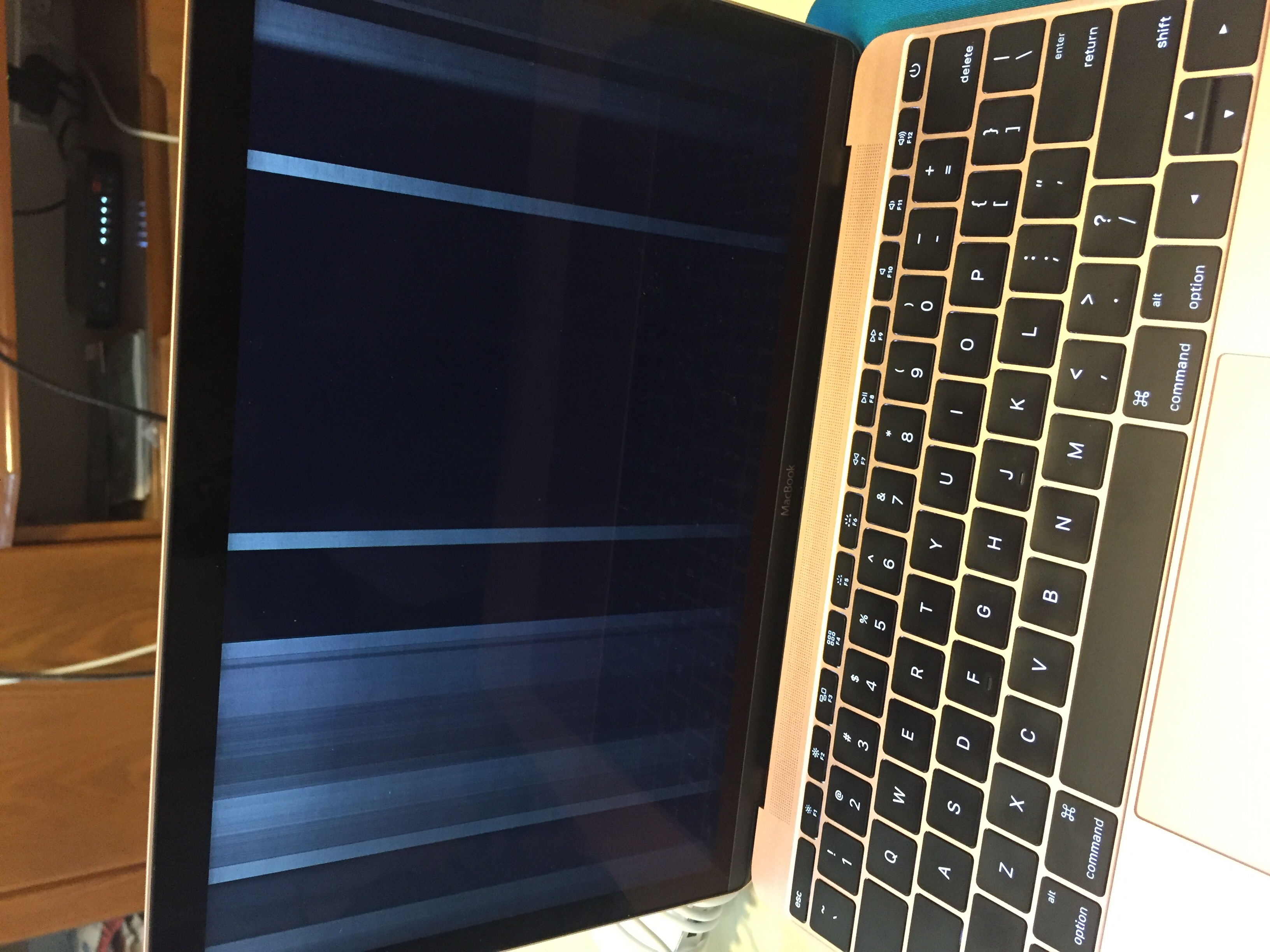

All of a sudden my 12" MacBook rose gold has black vertical lines in the screen and no picture. I tried command option P and R and it didn't help. Any advice?

It works with my TV. But it's not useful because I have the display settings for an extended monitor not mirroring so I only get the right side of the screen and can't do anything. Is it an easy fix?

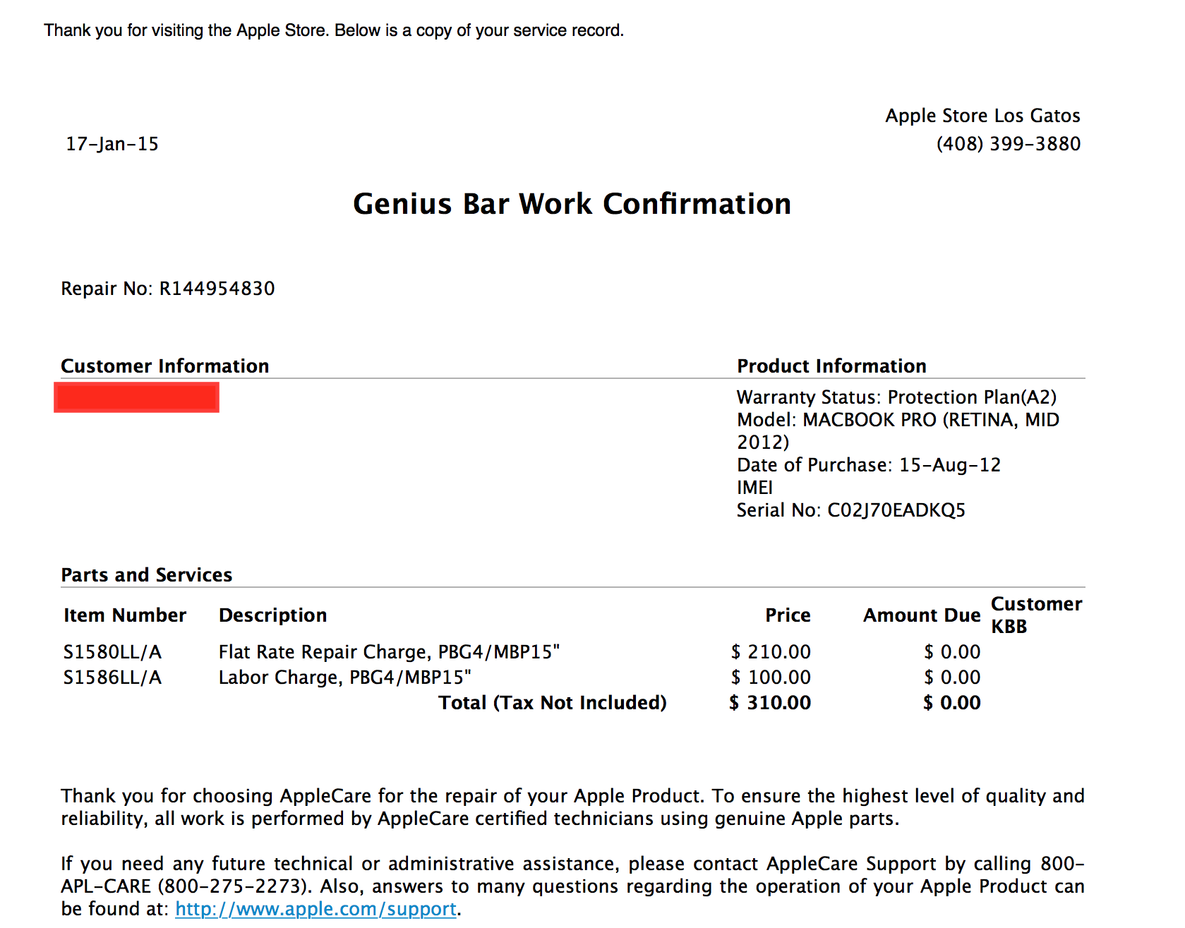

Last time they replaced my display under warranty, they gave me a receipt with a breakdown of the components. The display would have been $350. That was on a 15" rMBP, so I can't imagine the 12" rMB to cost much more than that just for a screen.

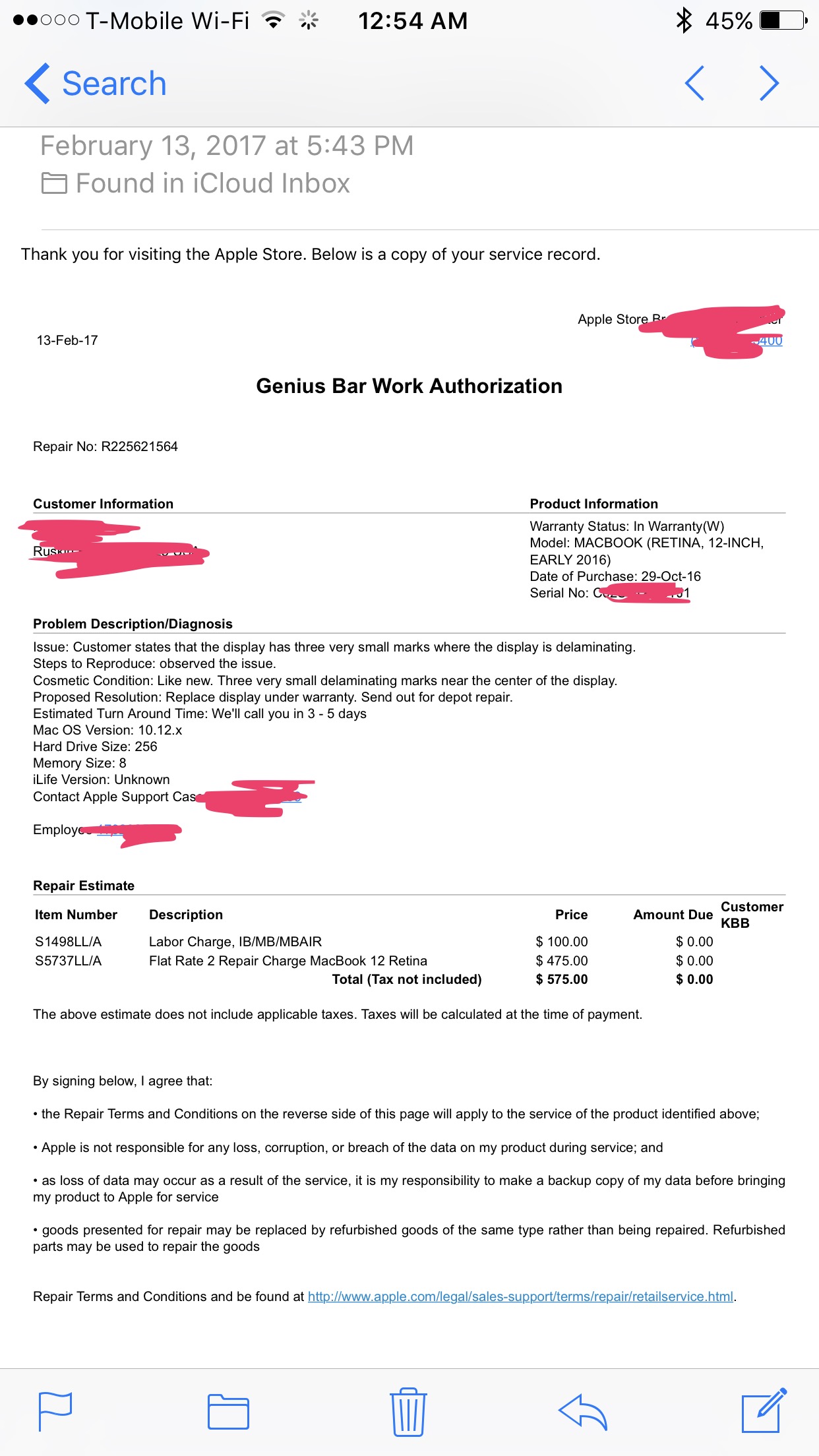

The screen is a $575 repair on the new rMB. They have to replace the entire top shell.
It must have been something else then. Here's my receipt.
It could also be that the 12" rMB is harder to fix than the 15" rMBP?
