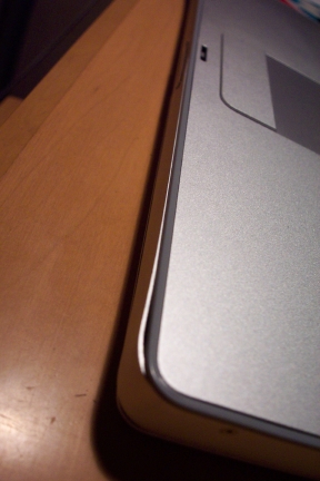

Here's a side shot of mine. I wouldn't worry. On the internet, most people complain more than they say how nice things worked. 🙂

madtodaimax said:
thanks for all the help. isnt that what the forums are here for...to discuss problems and see how to fix them?
Yes, but if all you hear are problems, you'll think every other 12" PowerBook has this issue. It is more like every 3rd. 😛
Don't assume yours has this issue right away based on forums alone. Lots of real world experience out there says that your PowerBook is probably fine. (Unless it looks like mine, that is)
