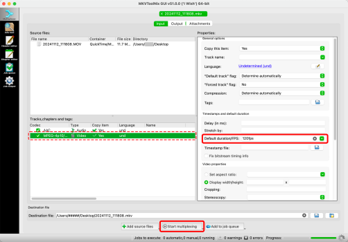

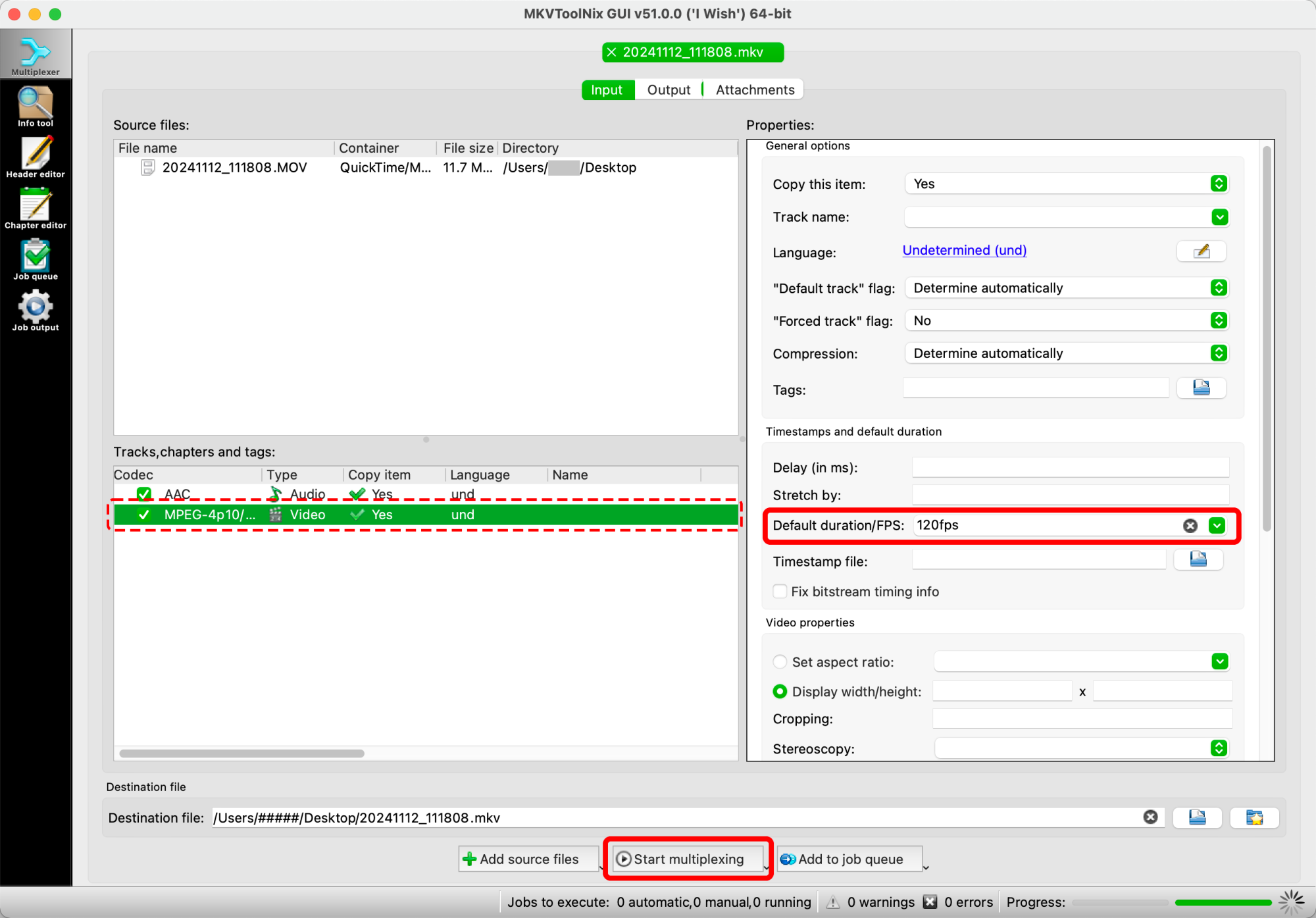

While there are likely more elegant ways, the few times I need to achieve what you seek, I do the following:
The whole process is lossless (only remuxing in different containers) and therefore very fast.
- Open the video file in MKVToolNix , select the video stream, set "FPS" to "120fps" and click "Start multiplexing" (see screenshot).
This will create an mkv file which now has the correct speed information (120 fps).
If you want the file to be in an mp4 container (for compatibility reasons), proceed:
- Open the resulting mkv video file in Subler , then click File > Save > MPEG-4 movie > Save
This will create an mp4 file which still has correct speed information (120 fps).
I am not familiar with iMovie, Final Cut or Avidemux which can possibly do the same in one step.
