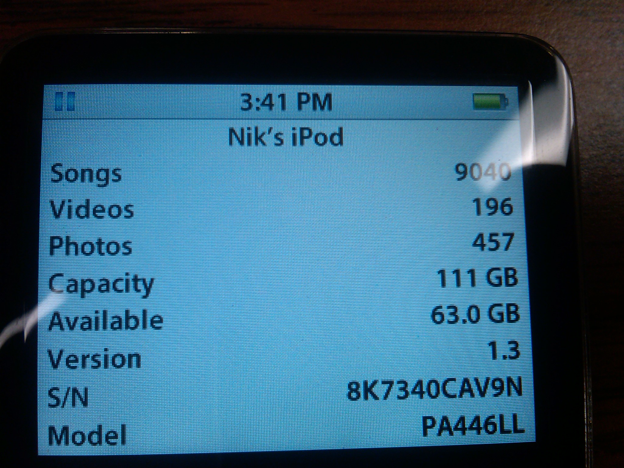

i recently upgraded my 30gb black video to a 120gb hard drive. the original drive went out, and it would no longer boot up, so i had nothing really to lose. bought a 120gb drive from a newer ipod classic off ebay, and it dropped right in. i used the repair guide from ifixit.com and had no issues opening the ipod and performing the replacement. now, my video works just as good as new, plus it has a LOT more storage capacity.

define lag? it plays just as fast as it did before. no noticable lag scrolling through the menus, and no noticable lag when selecting a song to play. i think you are worried over nothing. battery life hasnt suffered either.

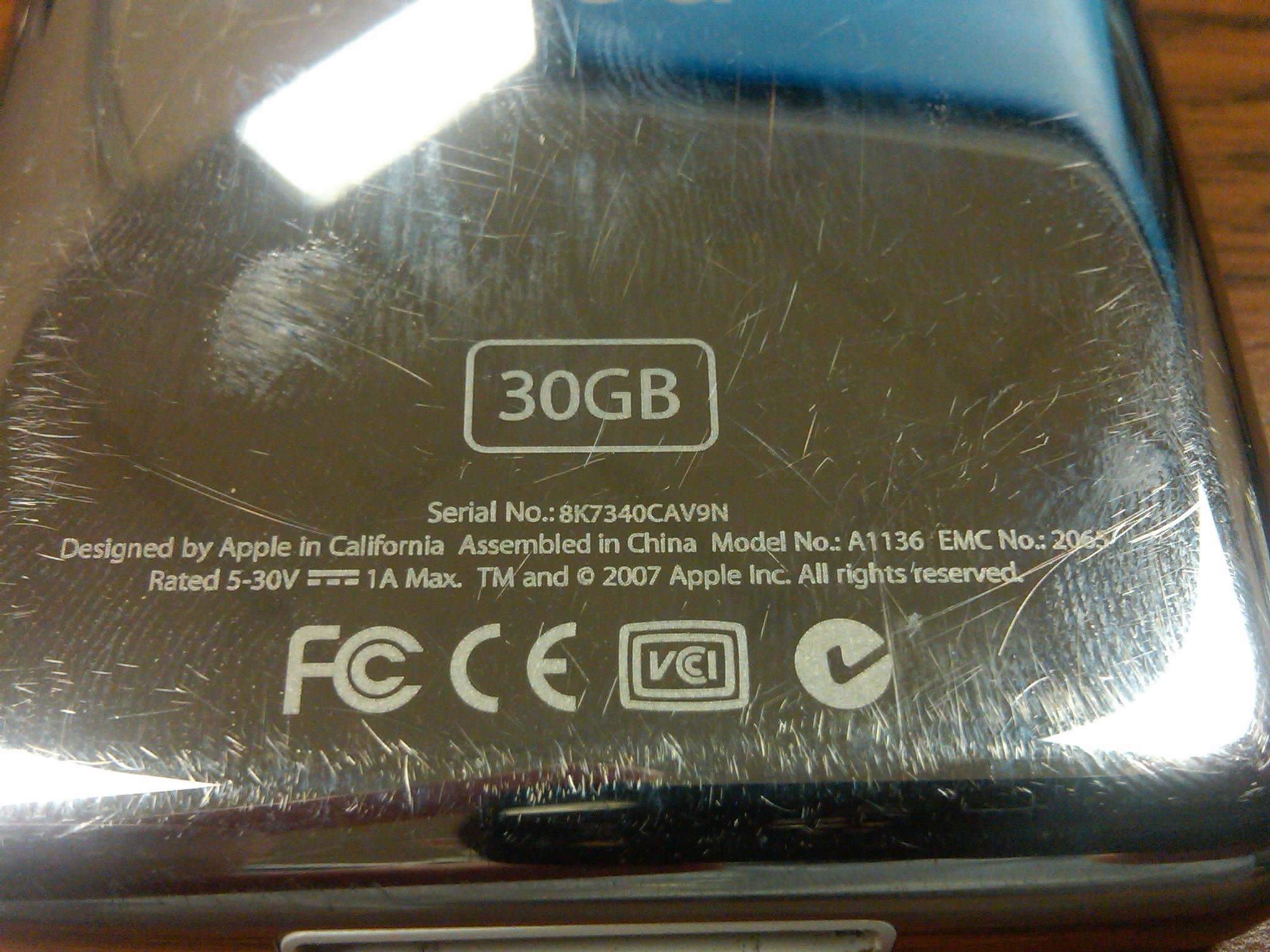

the only downside from the upgrade is that the back cover still says 30GB. (if you want to call that a downside.)

sounds similar. he is good about responding to questions. the 30gb ipod video takes the "thin" version of the drive. just send him a quick question through ebay.

You sound pretty sure that yours is a 30GB model though. I'm not really sure what's going on here, sounds like this guy knows what he's talking about too. Can you measure the thickness of your iPod please? Thanks!
well, it is a 30gb model. attached is the about screen showing the model number and drive size, and a picture of the back case engraving.
Cool thanks for posting. Was it at all a struggle to get the drive to fit in there? I wonder if there's a chance there's a difference in thickness between the two generations of 30GB iPods. i'm just trying to figure out why this guy, who I'm sure would like to sell me a hard drive, is pretty convinced it won't fit. Can you take a ruler to your iPod and measure it for me? Mine is 11mm thick.
I'm pretty sure I got mine when there was a choice of either 30GB or 80GB models, since i got it in mid 2007.
