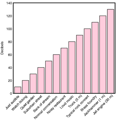

Only if you like a vacuum cleaner in your Mac. 55db... Ouch.
how loud is 55db
About the same as having someone constantly talking 1 meter away.
Its a lot louder than you think, especially if its always present. Most fans are less than 40db at full speed but of course airflow suffers.
