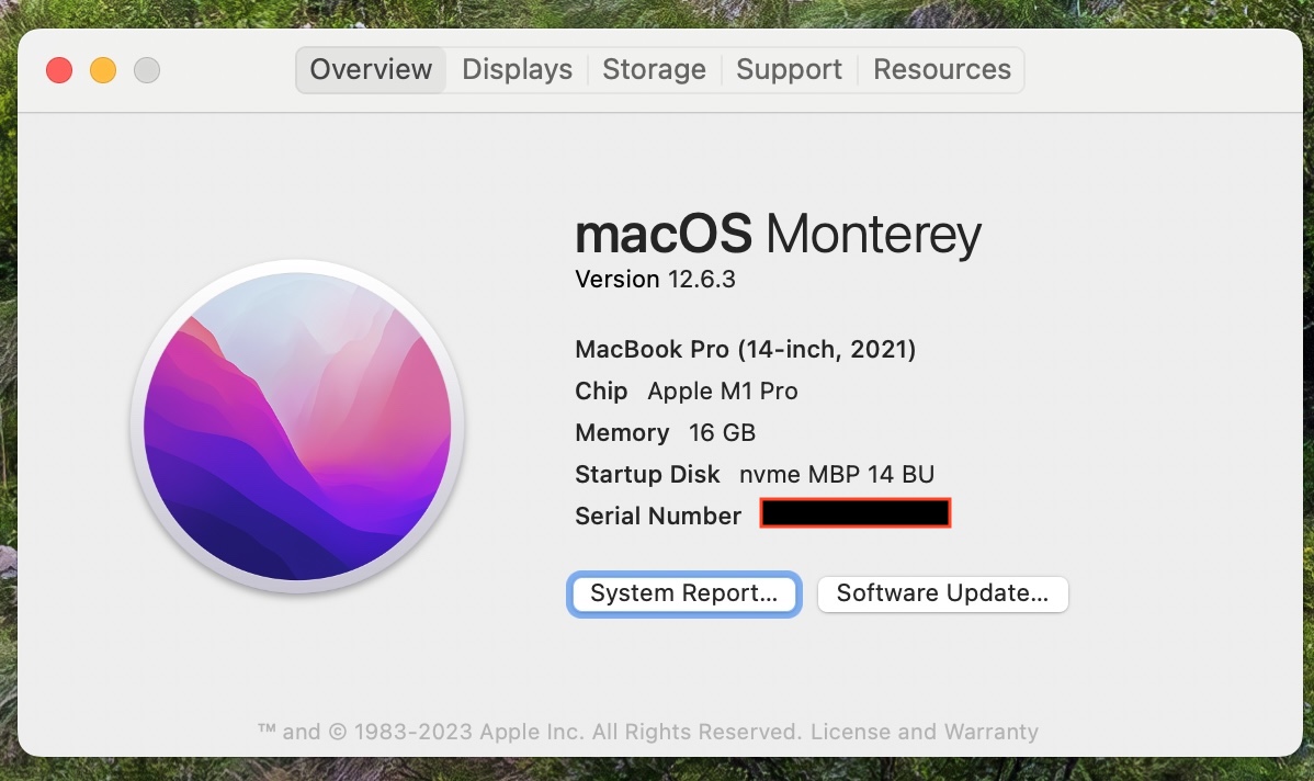

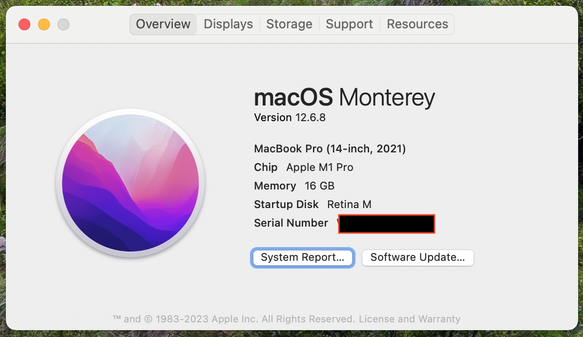

My 2021 MacBook Pro with an m2pro CPU will boot and run from an external drive (Monterey installed). Guess I'll have to post pics to prove it.
2021 MBP (booted from internal SSD, OS 12.6.8):
2021 MBP (booted from external cloned backup, nvme blade SSD in a USB3.1 gen2 SSD, OS 12.6.3):
