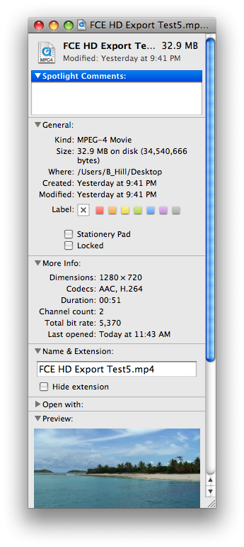

I then export the file and "upload" it into iTunes. This 51 second test file is approximately 33mb. I have attached a screen shot of the file info...I hope this helps. Thanks in advance!

I'm able to export for Apple TV without any problem, but that cuts down the resolution to 720x540...same as iMovie '08 was.
I'm trying to preserve the quality of the video as much as possible....so it looks as close to the raw 1080i footage that I download from my camera.
Where I seem to be getting stuck is that I'm unable to sync the 1280x720 file with the Apple TV.
