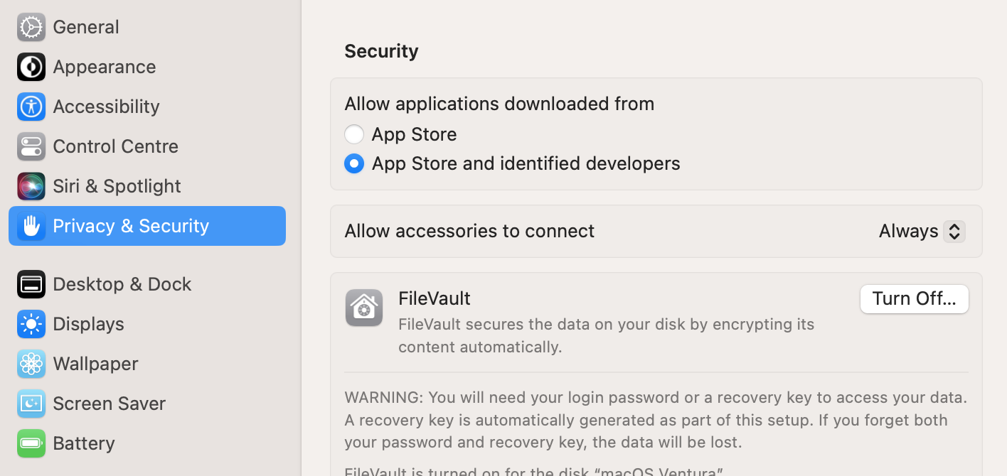

So interestingly, I sat down earlier this morning to take a look at the "System Report" and report back.
But upon attaching one of the drives in question I noticed the quickest "flash" of the "Allow accessory to connect?" window... it was an incredibly brief flash of said window before it closed itself down.
I proceeded to open up "System Settings > Privacy & Security" and set "Allow accessories to connect" to "Always" (they're mine, I can trust them) and...
Boom! The devices now connect, no issues, no nothing.
Not a clue as to why this suddenly became a thing, but for anyone else who maybe experiencing a similar issue then take a look under "System Settings > Privacy & Security" settings.
Thanks all 🙂
Thanks all 🙂
This saved my butt. Thank so much.
