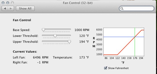

    Not really sure how to use Fan Control... This is what I got right now:
    [​IMG]
  6. bill-p macrumors 68000
    Joined:
    Jul 23, 2011
    #6
    Do you have anything running in the background? Looks like something is under load.
