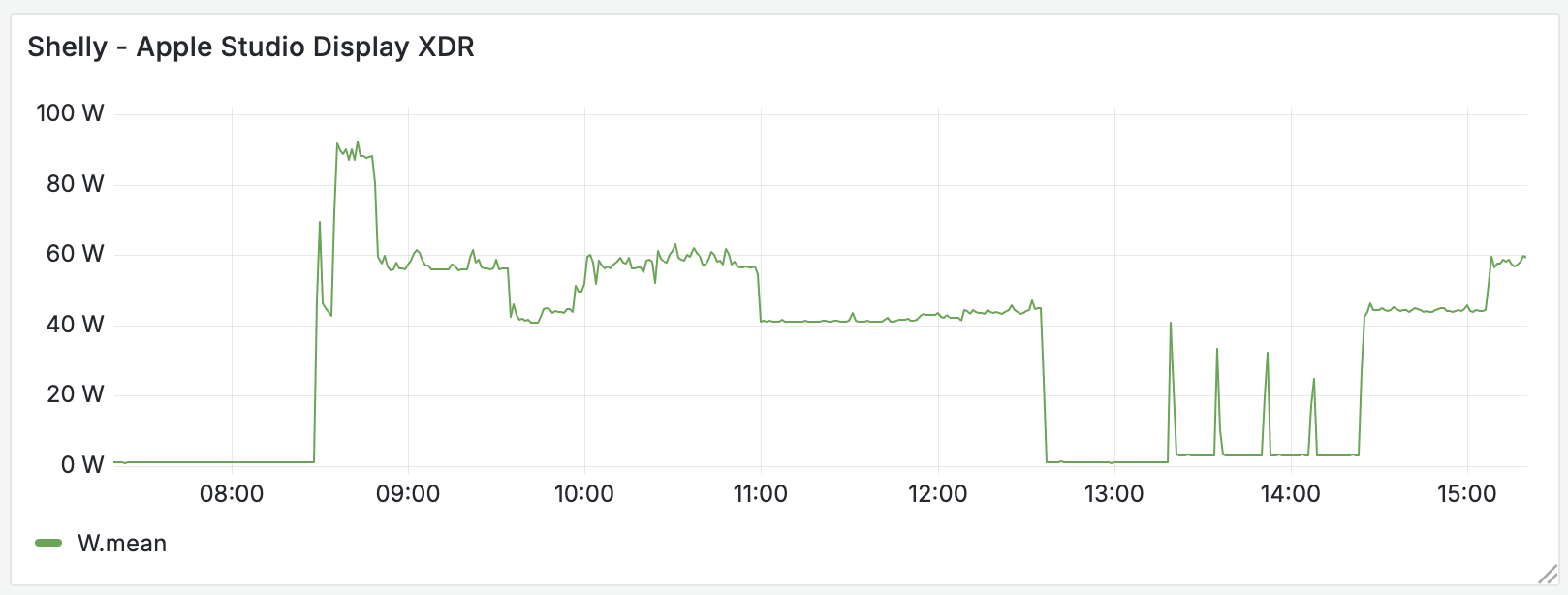

A quick screenshot from my smart plug with some context added:
  • Before 08:00: ASD XDR without anything connected, consumption ~1W
  • 08:30: MBP connected, charged to 80%, general use and eventually idle for over 10 minutes, consumption eventually settles to ~56W after charge to 80% completed
  • 09:35: MBP goes in system standby, consumption ~43W
  • 10:00: General use of MBP, consumption ~56W
  • 11:00: MBP goes in system standby, consumption ~43W
  • 12:35: MBP disconnected from ASD, consumption ~1W
  • 13:18: Thunderbolt cable connected, MBP still in system standby but not doing anything on laptop, keyboard or mouse (all wireless), consumption 3W with occasional small spikes
  • 14:23: No use of any device but macOS decides the deep sleep is over and goes back to 43W, while system appears in system standby
  • 15:08: I awake my MBP to start typing this post
Truly puzzled. When my MBP is not connected to the ASD, it all works wonderfully, stays in a sleep state for hours on end, only sipping energy, as the way it should be. But once you have an ASD connected, the entire SOC in the ASD stays awake, consuming energy without being used. Disconnect the MBP and the ASD goes back to a full sleep state, also as the way it should.

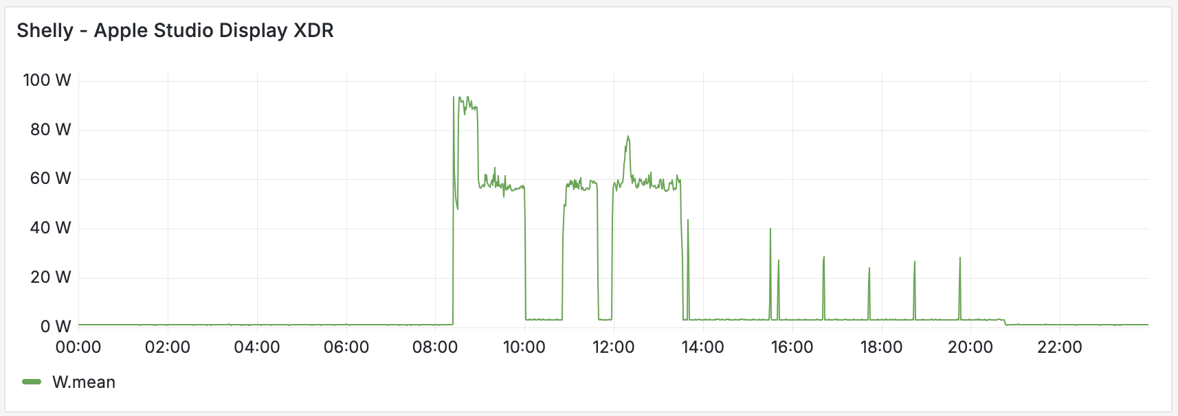

So, just to keep everybody updated, I think I fixed it:
  • Before 08:30: ASD XDR without anything connected, consumption ~1W
  • 10:00: MBP goes in system standby, consumption ~3W
  • 10:50: General use of MBP, consumption ~56W
  • 11:40: MBP goes in system standby, consumption ~3W
  • 12:00: General use of MBP, consumption ~56W
  • 13:30: MBP goes in system standby, consumption ~3W
  • 20:40: MBP disconnected from ASD XDR, consumption ~1W
I waited with posting this until I had about a week of this behaviour, and with both manually locking/sleeping the laptop, or letting it automatically go to sleep. It all works. The occasional spikes during sleep time are fine with me.

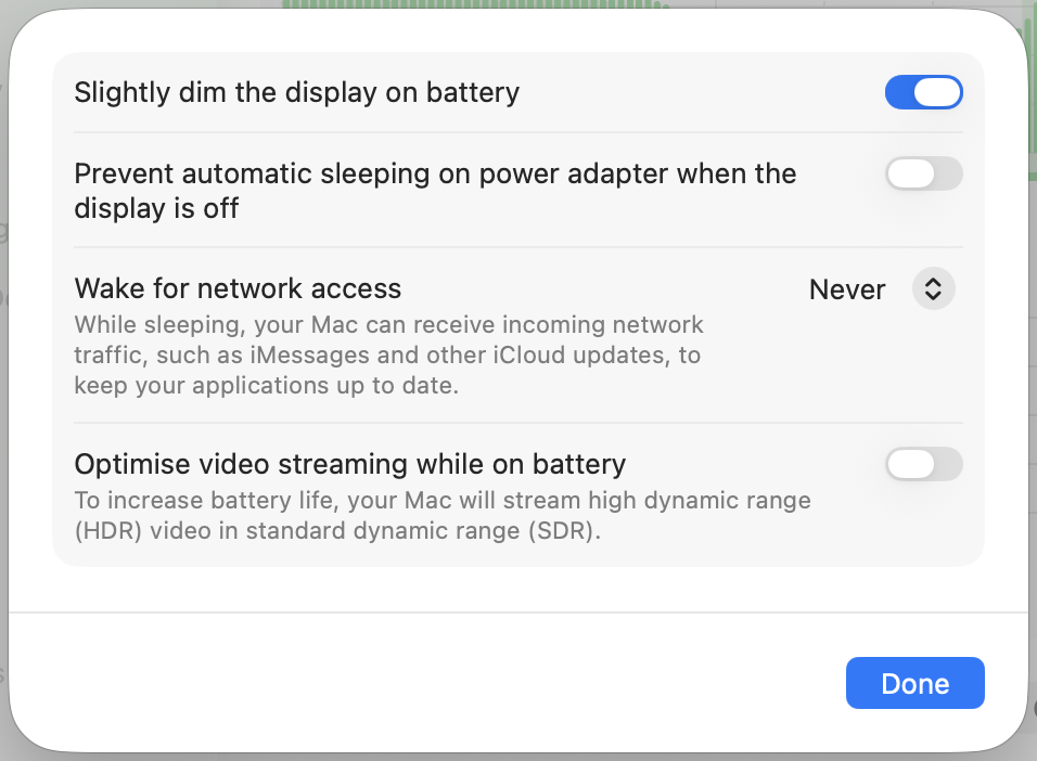

What did I do? Nothing fancy, aside from disabling powernap and tcpkeepalive. These are my settings:
Code:
$ pmset -g
System-wide power settings:
 SleepDisabled          0
Currently in use:
 standby              1
 Sleep On Power Button 1
 SleepServices        0
 hibernatefile        /var/vm/sleepimage
 powernap             0
 networkoversleep     0
 disksleep            10
 sleep                1 (sleep prevented by bluetoothd, powerd)
 hibernatemode        3
 ttyskeepawake        1
 displaysleep         20
 tcpkeepalive         0
 lowpowermode         0
 womp                 0
Would love to hear of anybody with the same/similar problem, whether or not these settings fixed it for them as well. I'm not sure whether it's the same problem as people have reported where the ASD fans keep running during standby.
