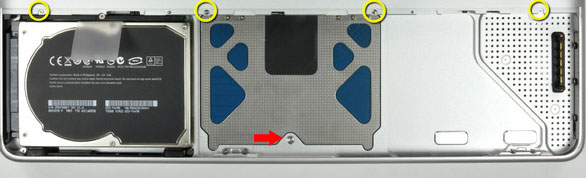

Did you try to tight the screw indicated by red arrow? I think that it fix mine.
i tried yet to no avail. you think i should buy an OEM trackpad and change it?
Before I did that I would probably stop by a genius bar and at least have them diagnose the problem. It would suck to buy a track pad and then find out that there was a screw or something that needed to be tightened.
