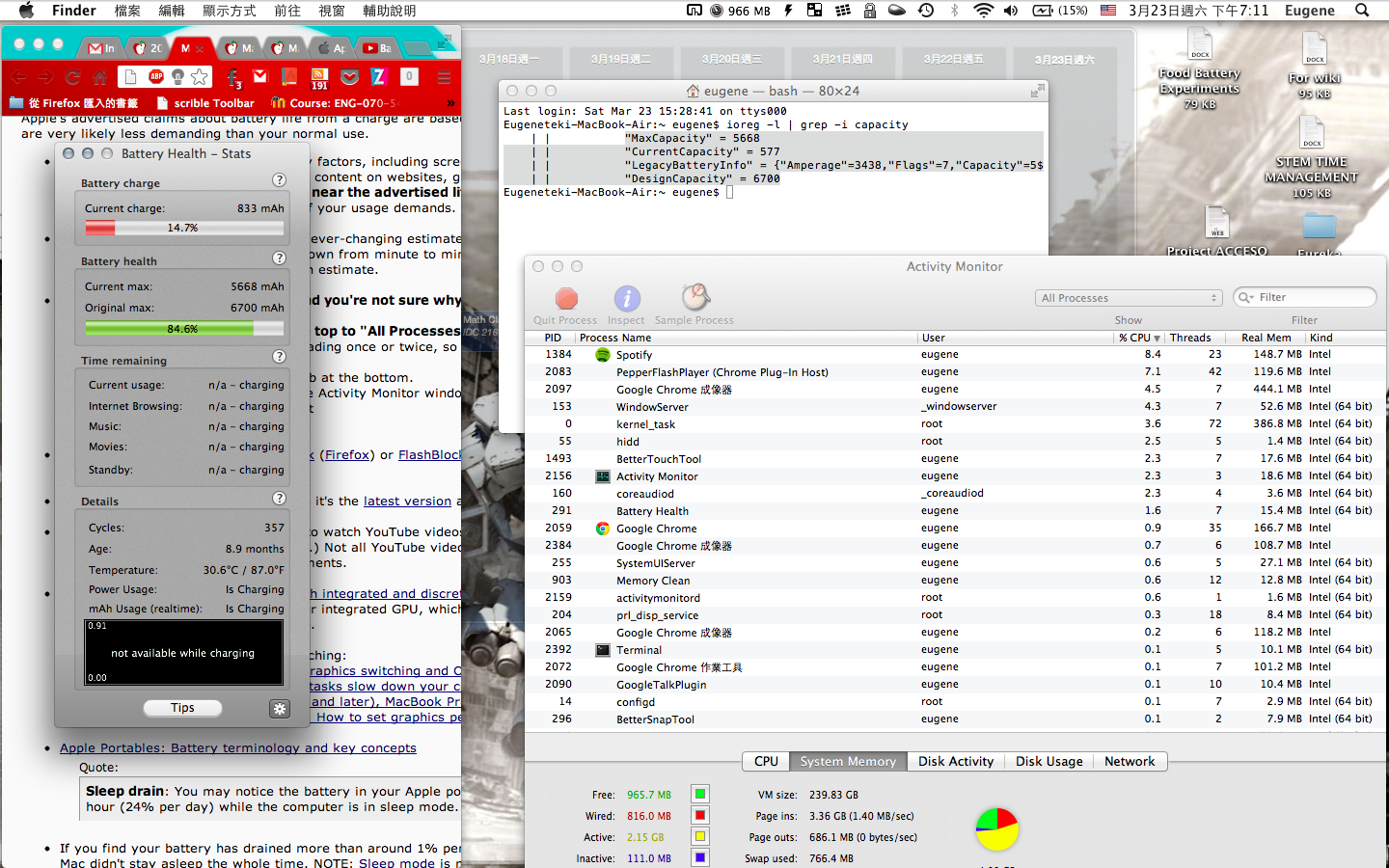

Ewang1
macrumors newbie
"MaxCapacity" = 5668
| | "CurrentCapacity" = 577
| | "LegacyBatteryInfo" = {"Amperage"=3438,"Flags"=7,"Capacity"=5$
| | "DesignCapacity" = 6700
Cycles: 357
8.9month old
Why???

Do not rely on apps to tell you battery health. They can be innacurate and fluctuate a lot.
As you discharged the computer completely 1.3 times per day in the last 8.9 months, you may have led to this by yourself. It is not necessary to discharge the battery daily if you have the ability to connect to power.

I see. I thought discharging would help the battery flow better... ( i mean healthier)
It does not with modern batteries. Read the FAQ I linked to.
Thx. Since the data appears on the screen may fluctuate sometimes, is it still possible to restore the battery life to at least 88% if I charging it all the time?
and if I'm not using my computer, still I keep it charged or leave it plugged in order to make my battery healthier?
and if I still have, for example, 70% left in my battery, should I plug in to let it recharge to its full capacity while I'm not using my computer( like while my computer is at sleep or shutdown)?

No, you can't restore battery health. Batteries die over time.
If you don’t plan on using your notebook for more than six months, Apple recommends that you store the battery with a 50% charge.
