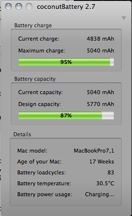

Battery - coconut battery (reads the same as istat pro)
normal? seems like thats not.
