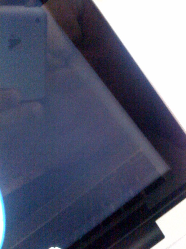

I purchased the 2.26 13" MBP (4GB RAM) yesterday afternoon. When I came home, I set it up and started to notice a couple of streaks (.5" thick) on the right side and half of the bottom of the screen.
I have a 9C9E screen and have it tested it on the Earth (centered) wallpaper with full brightness. It tends to go away after 40% brightness.
Sorry for the bad picture. Anyone else having this issue?

Exchange it. That looks like a manufacturing defect to me, nothing that you can (or should attempt to) fix on your own.
I returned it without a problem, however the exchange (9cbd screen) had the same problem. I decided to return it. I'm done.
Check those screens, folks!

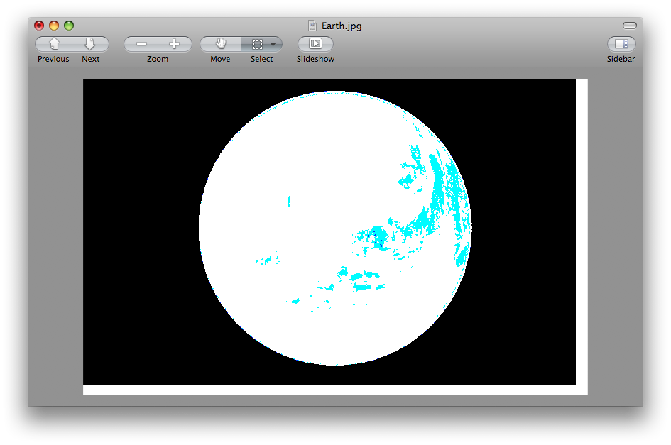

I love when OCD Mac users do stupid stuff. Constantly returning products increases the cost for everyone. It's on the earth image.

Yep!! I confirmed it. I opened the image in preview and sure enough. a strip running right down the right side.
there is also one running along the bottom, but the dock covers it when it is on the desktop. but yeah, 2 completely unwarranted returns.
