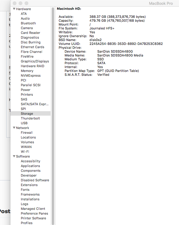

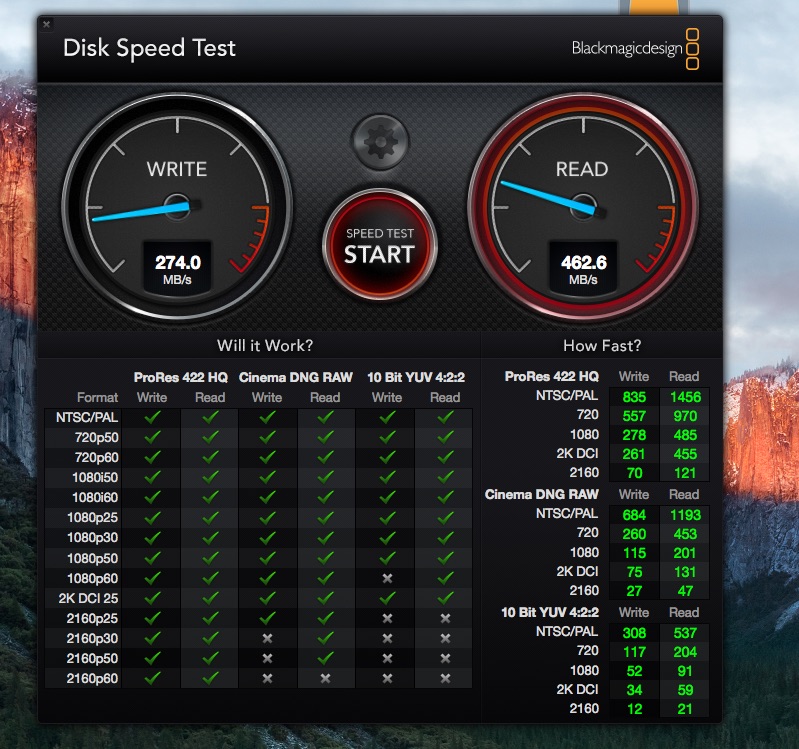

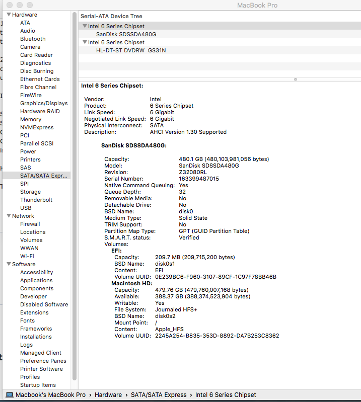

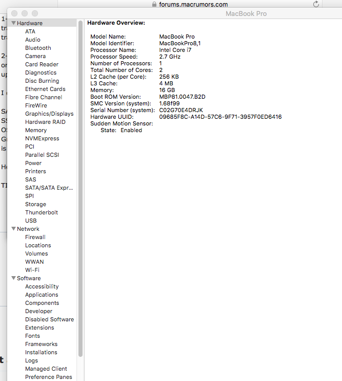

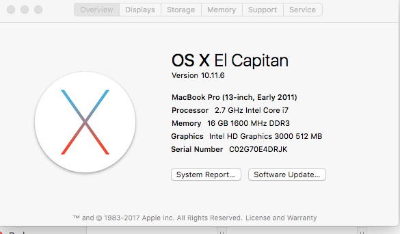

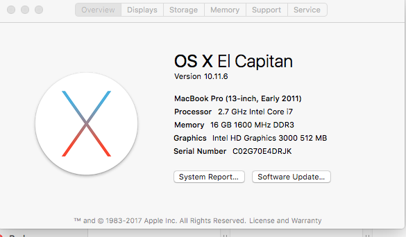

I bought a used 13" MBP from 2011 with Intel's i7, 2.7 Gb and Intel 300 512Mb graphics card.
Following the ongoing trend among my peers, I decided to upgrade the RAM and HD to 16Gb and SSD respectively. Adorama did it for me actually.

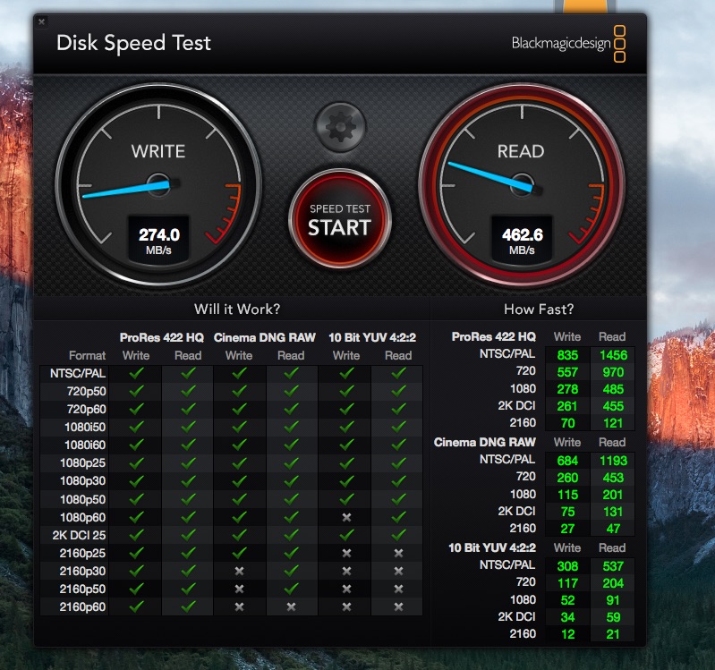

Ever since, even though my comp is booting very fast (about 20-30 sec) I did find it strange that:
1-When I transfer files from SD camera card via built in SD slot or from external SD/CF card reader, or if I transfer files from one external HD to the other (regardless if its USB or FW800) it rapports unusually long transferring times (2 hours for 45Gb).
2-When I preview video files (HD or 4K UHD), or even if I play them through QTPlayer, VLC, FCPX 10.2.3 or Adobe Premiere 2014 CC, it stutters and plays it choppy. The thing is that, before the RAM, SSD and OS upgrade, these files were played normally without and jerkiness and stutter.
I did some research online but can/t figure out what could be a problem 🙁

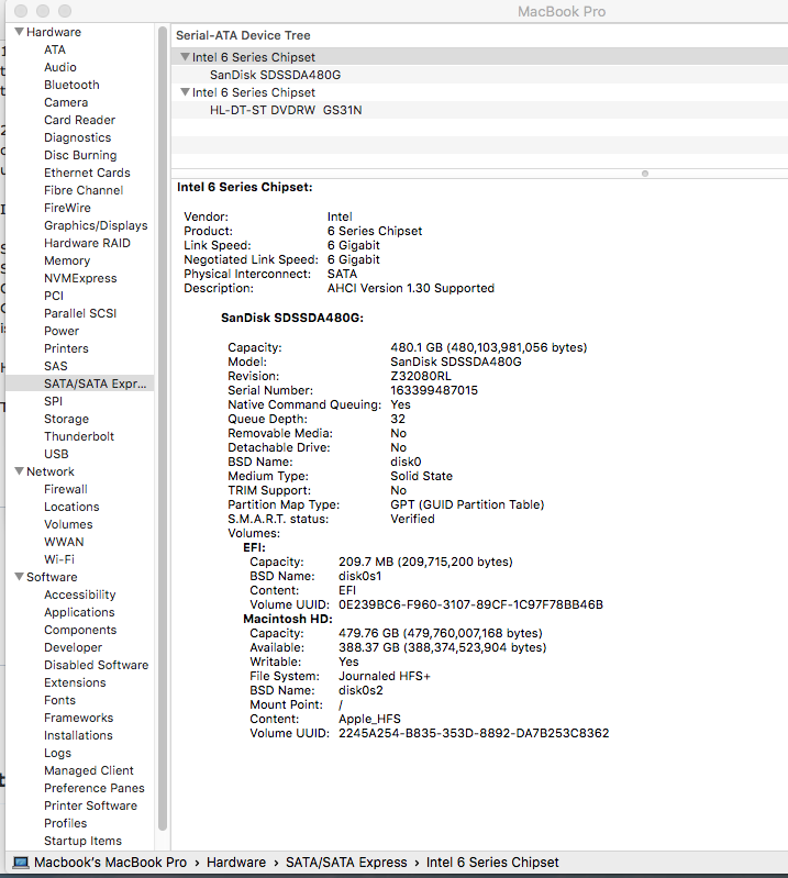

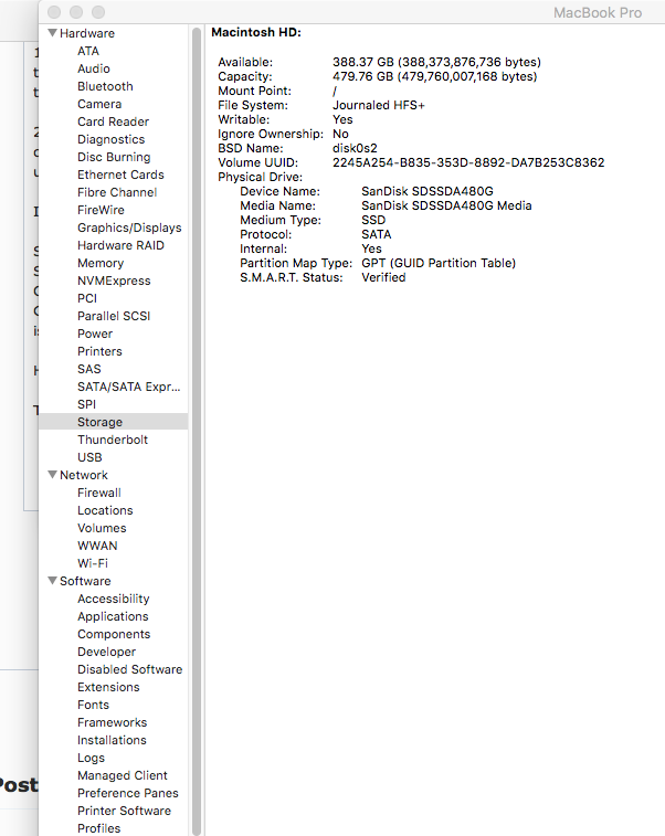

SATA Cable? How can I be sure it is that?
SSD incompatibility? But it seems like the one I have is a proper one.
OS? Should I downgrade t oYosemite? Should I upgrade to Sierra?

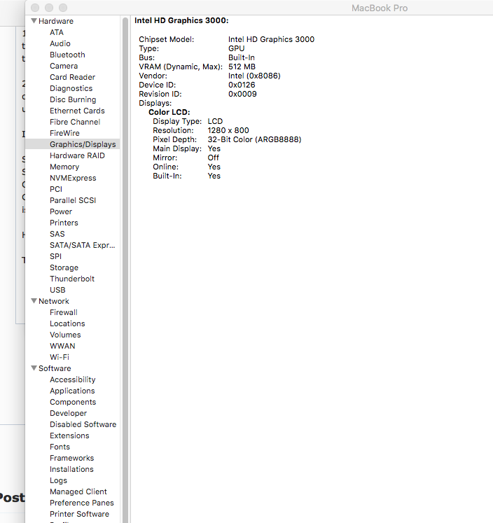

Graphics Card is not up to the task? But then, Why would it play it normally with less RAM and inferior HD is its a bout the graphics CARD.
How can I nail it what is a potential problem?!
TIA for any kind of gudanance!
Comp.png Graphics.png Hardware Overview.png HD.png Memory.png SATA.png USB.png SSD.jpg

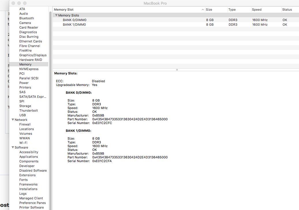

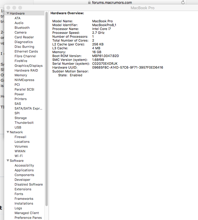

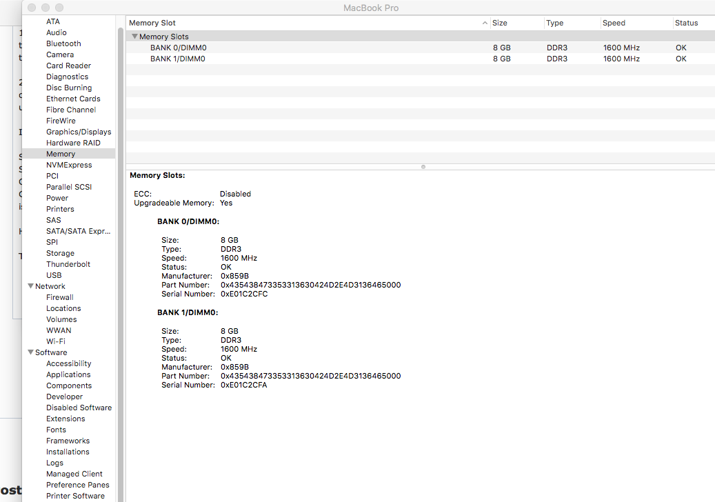

The RAM they've installed is 1600MHz. It should be 1333MHz on your model. I would wager that could be causing a problem, however it may also be the SATA cable as the 13"s tend to have a bit of an issue with them.
A faulty SATA cable is a little more difficult to check, though you can run SMART Utility and see if there are any errors detected with Ultra DMA CRC Error count. That would 100% verify it's the SATA cable if there are any problems found (though it may not display any warnings even if it is failing). SMART Utility can be downloaded here: https://cloudfront.volitans-software.com/smartutility323.zip
You can also try reset the PRAM by holding CMD + ALT + P + R on startup until you hear the Apple boot chime 3 times, then let go.

Do you have the specifics on the RAM being used?
Have you ran the Apple Hardware Test, and did it throw any errors relating to the HD or RAM?
The 1600 MHz RAM is generally used without trouble in this model. Adorama has no doubt done a lot of this kind of thing. If it were the RAM, one might expect worse problems, I think, but maybe it's still possible.

1. My ram is 1600mhz, it is perfect; Crucial brand.

The Sandisk is a brand I wouldn't buy or use; did you install TRIM? Why did they use Sandisk brand and not Crucial or Samsung?

I installed TRIM but it still doesn't seem to be as efficient as I was hoping for.
Do you also have intel 3000 graphics card?

Yes same graphics card for all 13" MBPros in 2011.

1. bad Sanddisk SSD
2. bad ram
3. Failing video card
4. Bad install of OSX
Something tells me it's the SSD.
