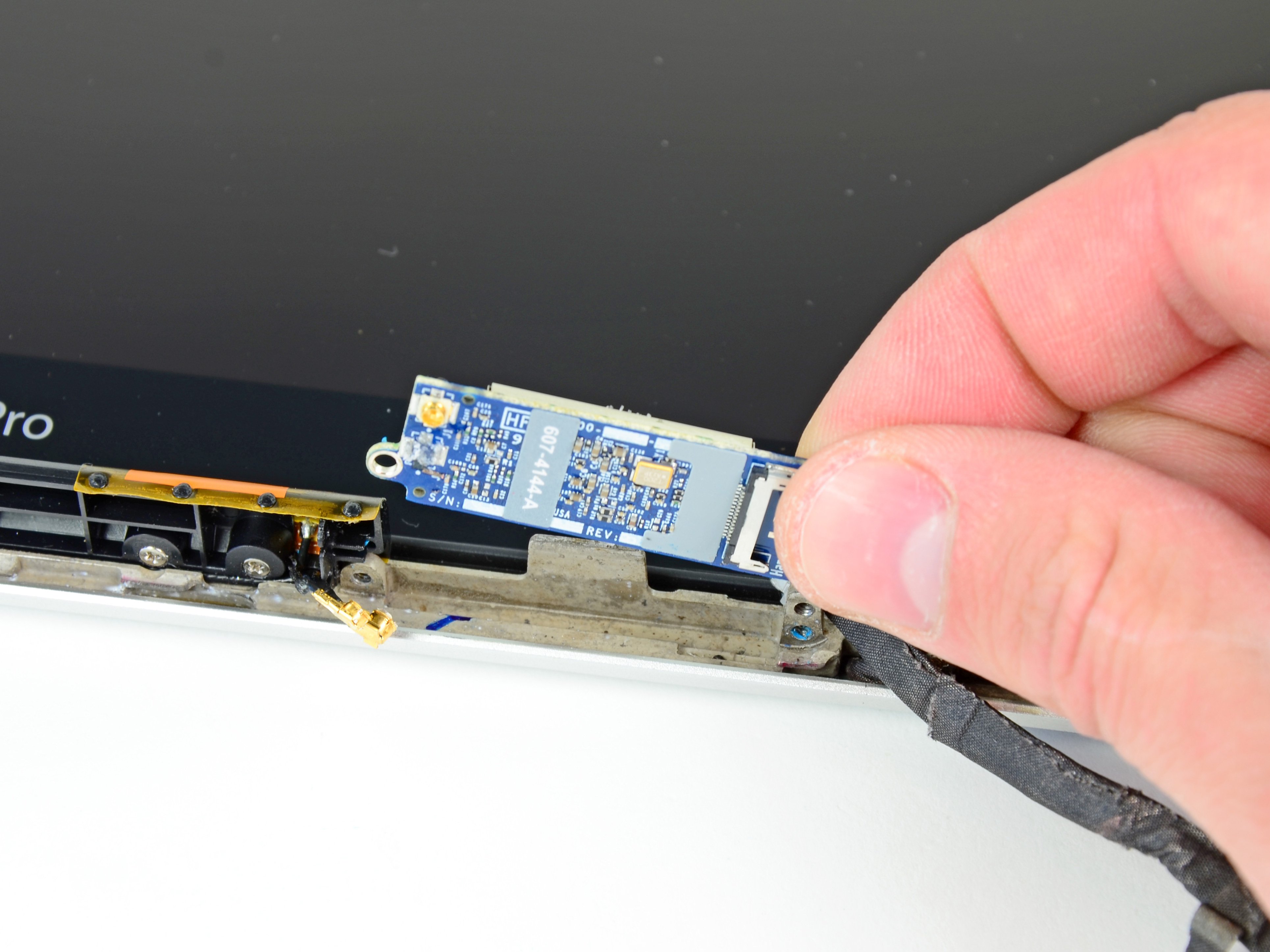

At least two different wifi cables/AirPort cards were used in MacBook's when this unit was made . The one I have is like the one shown at

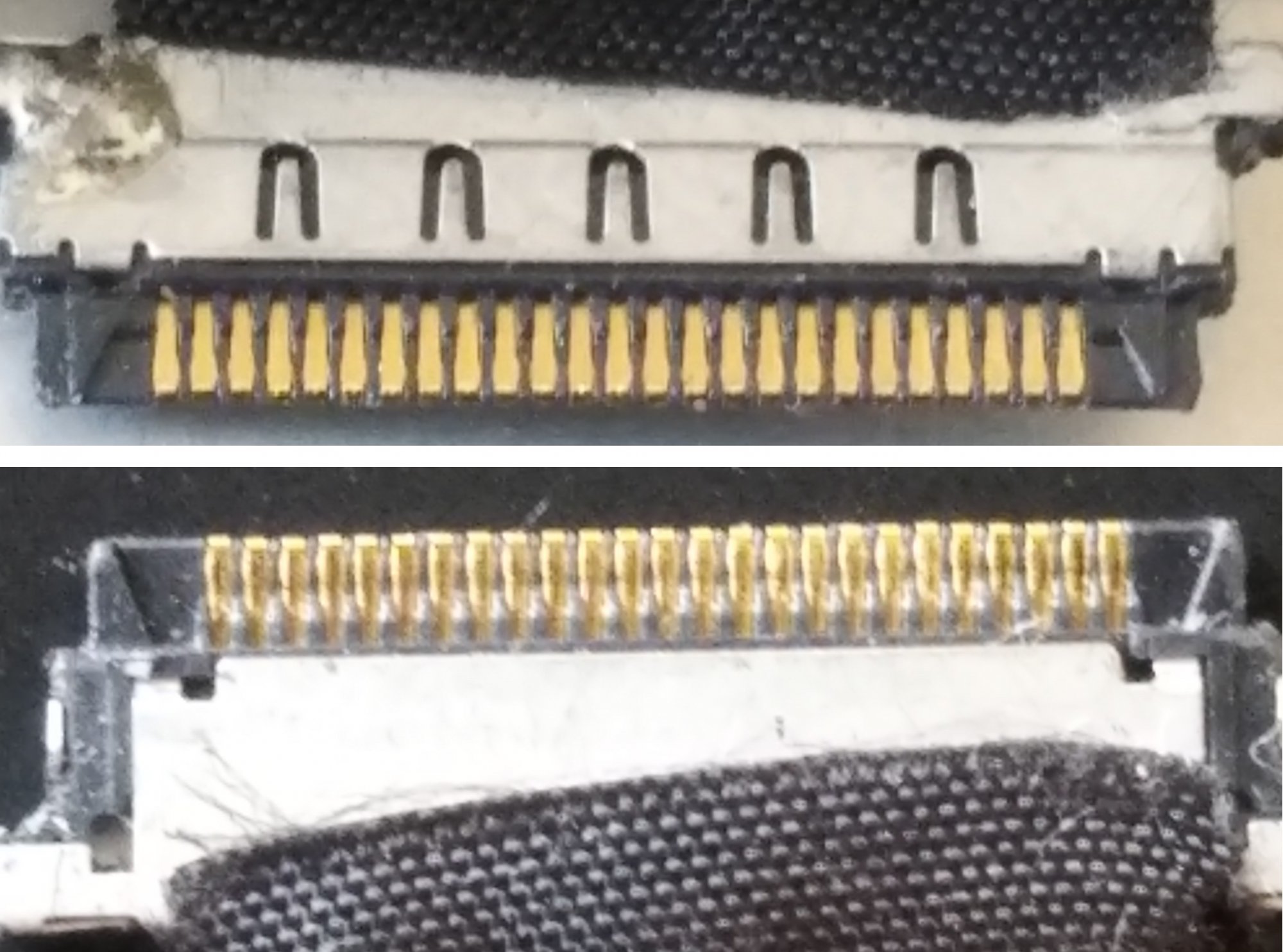

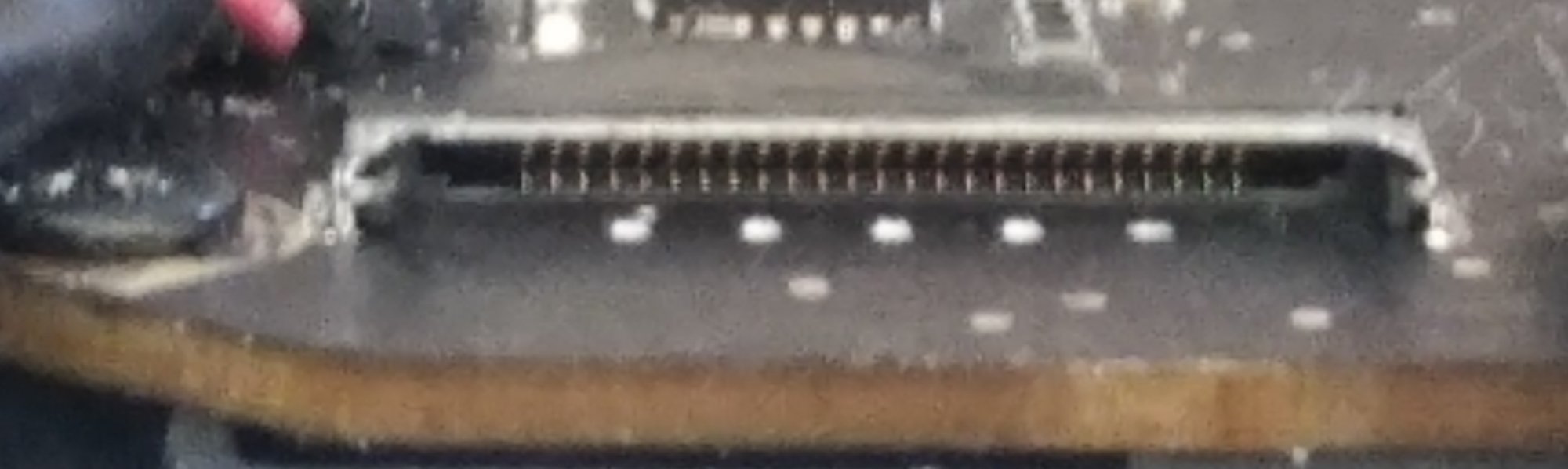

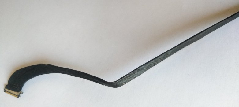

Thanks a lot for the suggestions/detailed rationale Multifinder17.
The cable pins (likewise those on the socket where it plugs into the mainboard) shown in the attached pics seem straight and free of debris - but please tell me if you think otherwise - or if my pics don't show enough to really tell.
I also gave them a nice alcohol bath/swab and a clean out with compressed air - but no dice unfortunately - still no wifi :(
The cable also seems free of damage or additional kinks.
Any other suggestions would be welcomed. Other than replacing the cable/AirPort card assembly, I can't think of anything else to try...

I would agree that it's almost certainly the antenna cable.
The fact that I can get a bluetooth internet connection suggests the Airport card /connection are ok and yes this points to an antenna problem. Except I didn't go anywhere near the antenna assembly (which is securely concealed inside the hinge housing) when I did the upgrade, and the system report shows no wifi activity indicating that the OS is not accessing the wifi component of the Airport card. Wierd huh!?!
I also just disconnected / reconnected the cable while it was running. The Bluetooth functionality turned off then on again - but no sign of any wifi, including in the system report.

In my case the cable looks ok but I have a bad feeling that I may have damaged the wifi related pins in the socket where it plugs into the mainboard (as suggested above by MultiFinder17 and another poster on another site I googled). It's hard to see in there and while the pins look ok, they only need to be slightly out to fail to make good contact. Very frustrating...!
