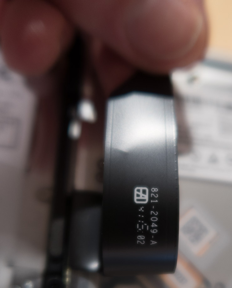

UPDATE: now here's something interesting. I decided to take a look inside and look what I found!
Although the cable isn't exactly cut in two it appears to have been mistreated, somehow forcefully folded, and I'm guessing there's an intermittent contact problem. The computer was bought brand new and never before opened, so I have no idea how this has happened.
Surely this must qualify as a warranty issue.

I read that some people have been receiving cables that are a bit longer than the original Apple one, but perhaps some dealers only sell one cable which works for both the 13" and 15" MBP. I should probably just go for another 821-2049-A, but how about 923-0741 mentioned above? Is it an improved, newer cable?
Several Chinese eBay sellers have the 821-2049-A or 923-0741 (often referred to with both numbers!) for around US$ 13 and onwards. Are these usually fakes or the exact same cables as Apple uses but not sold through the correct channels, thereby a lot cheaper than if you get them through an Apple service centre?

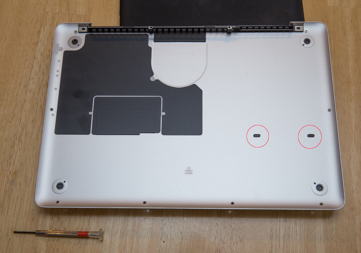

Midnight_habit: I'm not entirely sure, but I think the soft black "pads" shown in the photo below right after I got my MBP back from servicing wasn't there to begin with. Has anyone else here noticed them originally or after having their MBP repaired?
I suppose Apple may have learnt their lesson and try to prevent it from happening again.
