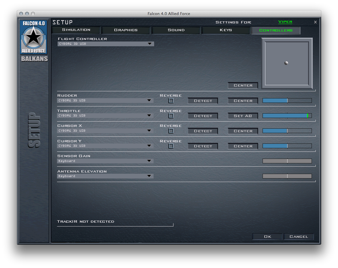

I have a problem with my just bought (on App Store) Falcon 4.0 Allied Force for OS X: when I try to calibrate and use a joystick (Saitek Cyborg 3D), though correctly centered in rest position using the "center" button on the Controllers panel in the application, the rudder, cursor X and cursor Y controls behave incorrectly. I put on line some screenshots showing the problem.
This is what the panel regularly shows when the joystick is pushed to the extreme left:
http://www4.picturepush.com/photo/a/7680997/img/7680997.png
Joystick on the extreme right:
http://www1.picturepush.com/photo/a/7681014/img/7681014.png
Joystick all forward:
http://www1.picturepush.com/photo/a/7681069/img/7681069.png
Joystick all backward:
http://www2.picturepush.com/photo/a/7681075/img/7681075.png
Joystick "rotated" left:
http://www3.picturepush.com/photo/a/7681046/img/7681046.png
Joystick "rotated" right:
http://www2.picturepush.com/photo/a/7681060/img/7681060.png
Joystick in rest position:
http://www3.picturepush.com/photo/a/7680826/img/7680826.png
In short, the behaviour in all "axes" is not symmetric — in example the value when the joystick is "far right" is much greater than when it's "far left", so the joystick is not usable in the game.
I link one more picture, showing all the previous pictures overlayered:
http://www2.picturepush.com/photo/a/7680980/img/7680980.png
Of course, the joystick works flawlessly with other games and flight sims.

Actually I contacted Graphsim support a couple of days ago, and they have just replied — with bad news for me:
"Unfortunately, this stick will not work with Falcon. The issue is that
older joysticks read ranges differently than newer ones. Any post 2007
stick will work. Maybe some from 2005-2006 as well, but definitely anything
post 2007. If you purchase something a retail store has on their shelf now,
you'll be safe. If you purchase online, look for the release date of the
stick. You can get one comparable to your current stick for $30. The
newest Cyborg models work well. Just make sure the replacement stick has a
hatswitch. You'll need this for views within the sim."
Looks like it's time to buy a new joystick...
