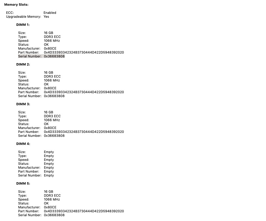

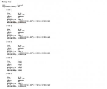

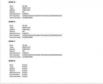

[doublepost=1562707972][/doublepost]And they all show same part number and same serial number......NEVER seen that on a RAM chip!!!!!

What CPU do you have? Exact model, not just speed.
According to his signature, it seems that they are dual X5690.
