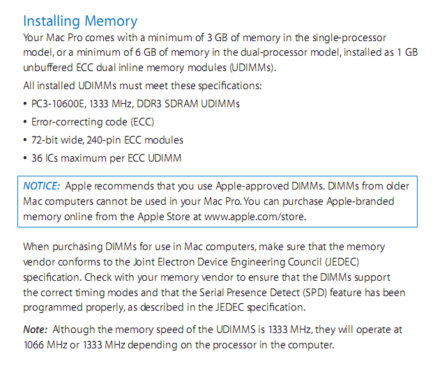

As CaoCao said it will down clock. The 2010 Mac Pros all come with 1333MHz memory according to the manual.

The 1333MHz RAM will work in all 2010 MPs, but not all of them can run it.
The 2.8, 3.2 Quads, and the octos run at 1066. But the 3.33GHz hex, and the dodacores can run at full 1333MHz speeds.🙂

Here is the page from the manual
