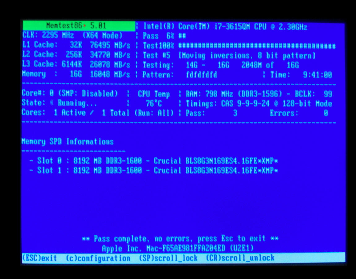

    I use the same Mac mini and I use this RAM in the Mac mini.
    Memtest86+ result
    [​IMG]
  8. Pieterr macrumors regular
    Joined:
    Mar 22, 2015
    Location:
    The Netherlands
    #8
    Totally agree.
    These work fine in the Mac mini 2012:
    Crucial CT2C8G3S160BMCEU
    Corsair CMSA16GX3M2A1600C11
    Kingston KTA-MB1600/8G
