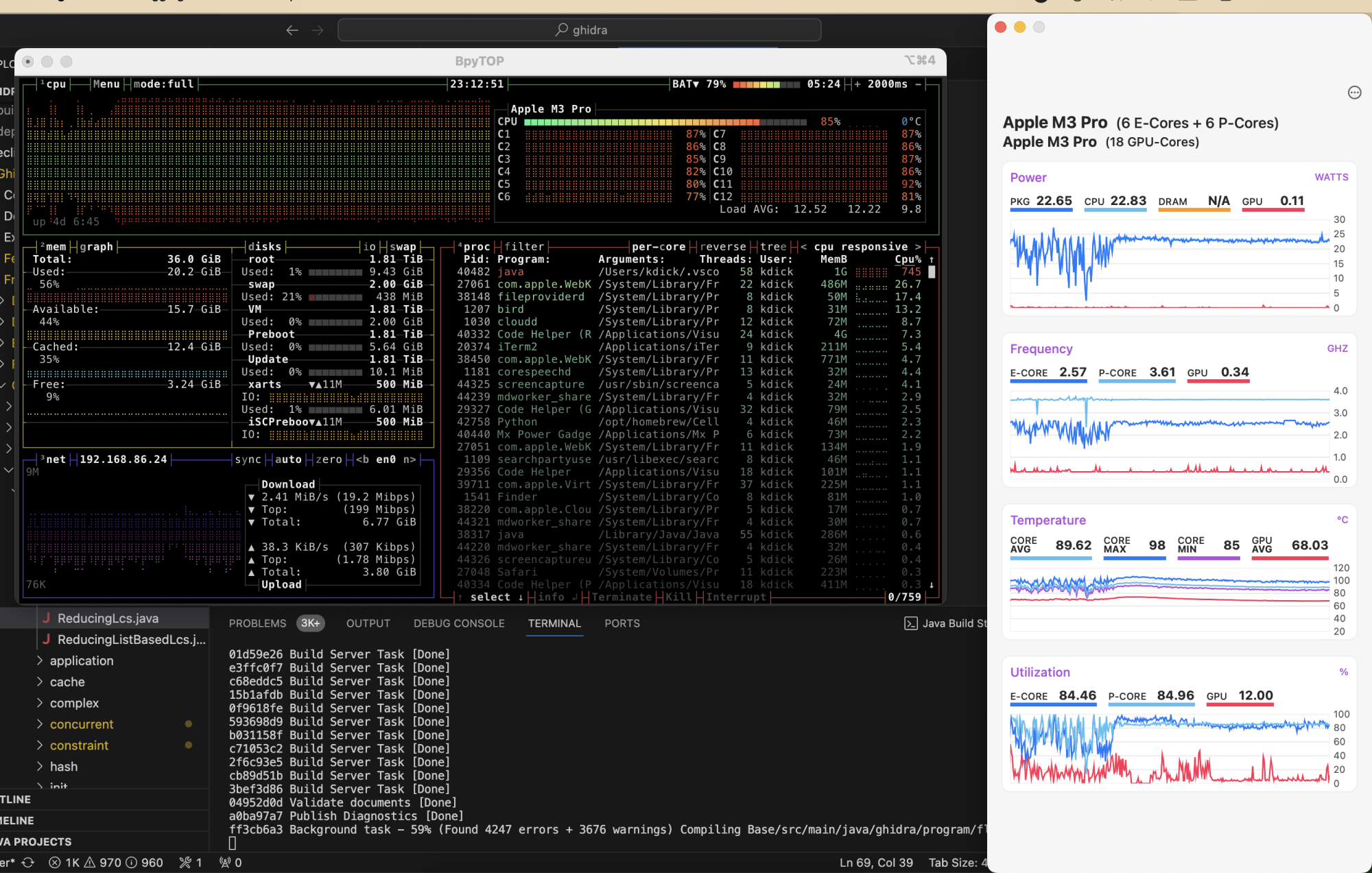

Got the m3 pro and and it is much more stable under load than the max was (and my air was). The air would throttle but at least stay at a reasonable speed, the max crashed straight into a wall.
Wish I could have the speed of the max but happy with the pro in this form factor. At all core loads stays at about 25 watts and have no issues now.
Baldurs gate also runs great, much more stable/smooth than the max was.
