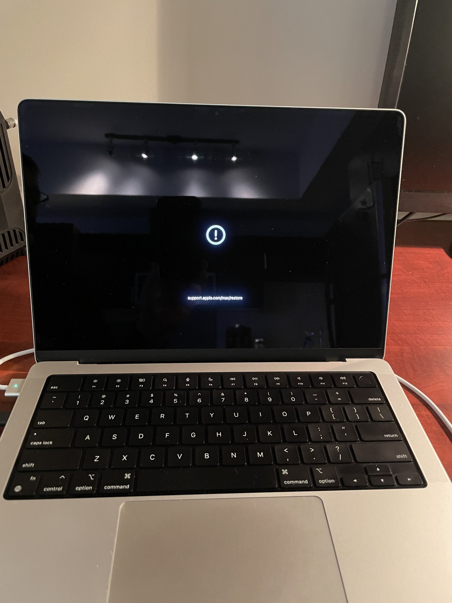

I had the awful issue of the screen being stuck at 50-75% brightness with all auto dimming functions off. Went to restore from a time machine and system locked up and rebooted. And now I no longer have a working system. As I’m travelling for business I will swing by the Apple store. Maybe a simple USB installer can fix this, any suggestions on a fix or is my system is toast?
My System display is still really dull in comparison to other 14" displays from the apple store yesterday. Is here a proper way to really reset the NVRAM on the M1 systems. Would anyone with a 14" Pro be willing to run in terminal nvram -p command and look for the display brightness level while at full brightness. My NVRAm indicates
backlight-nits 0x012c0000 - although the system seems to be at bout 80% of what it should be at full brightness.

All Auto dimming functions are off. I have a ticket into Apple although they couldn't pinpoint the issue. The system was corrected from the boot issue, although the Display is just dim. I would assume this system will be replaced if Apple support can't provide a solution. It's disappointing as the issue is software related as in HDR video you will see the display increase in the areas where it should and overall. It's just dim while working on the desktop, jump to a full screen HDR video and it's perfect and bright once again, back to desktop and it goes dim.
