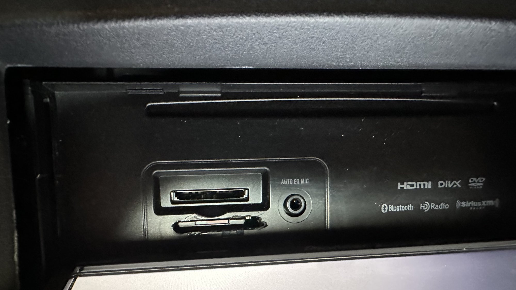

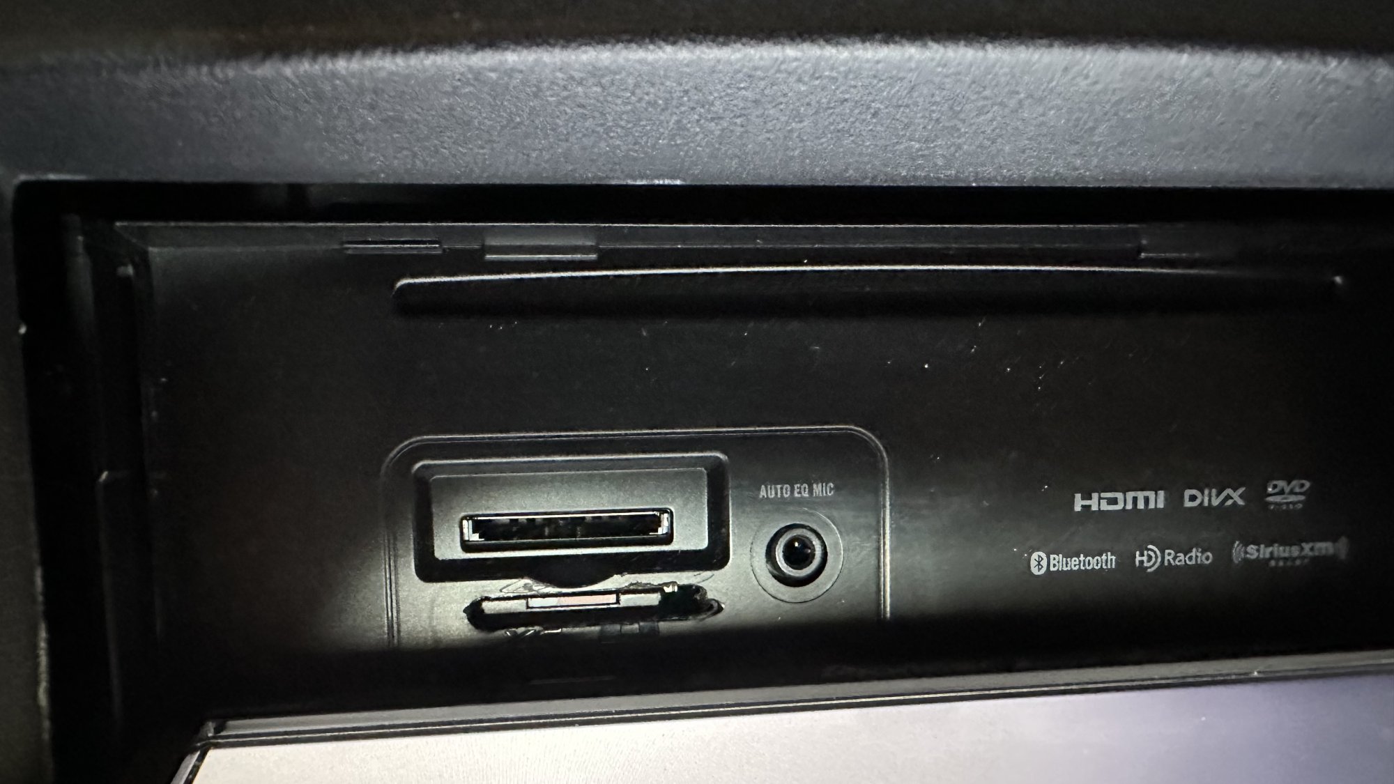

I fixed my CarPlay issue. I had to take it apart and replace the internal SD card with a fresh copy of the operating system. It was quite the ordeal. No issue with Apple, issue was with pioneer making a poorly engineered product (or bad software). Fortunately it was relatively easy to fix.
Link to how to reimage 4400 nex
I also cut a little bit of the cover to easily replace the SD cards if it goes bad again. But it’s working perfectly again. I am a bit critical with pioneer that they didn’t create better software (and abandoned support) but I’m happy it was easy to fix and it’s a pretty good head unit. When you factory reset the radio it doesn’t totally reset because it remembered my old iPhone and i believe that was the issue. If pioneer developed it to really factory reset it would probably have been fine.
