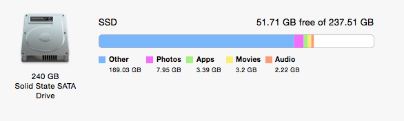

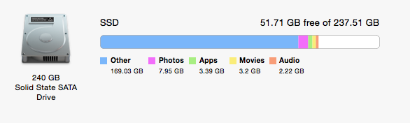

Hey, folks! The "other" category on my Early 2011 mbp is out of control. My Crucial SSD 240 gb is reading that it has 140 gb in other.

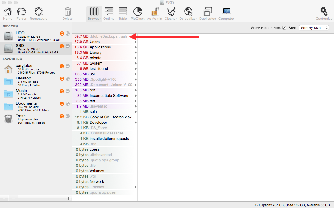

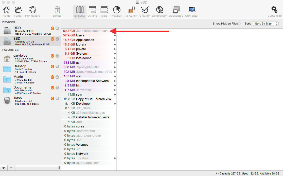

When I ran WhatSize, I ran it as an admin. When I do this, it shows the following:

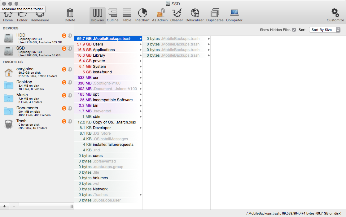

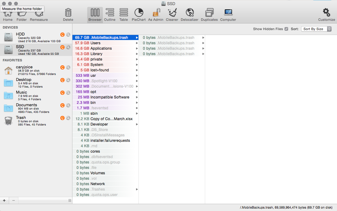

However, once the file is expanded, it shows 0 kb on everything.
When I try to empty this "trash" file, it refreshes and goes from the 60 gb to 0 kb. So, that's not working either!
