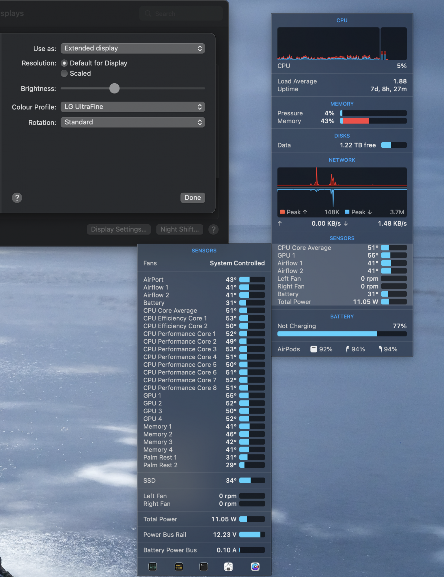

Been watching this thread for a while but could not confirm as my iStat Menus was not updated. I can now confirm that the fans stay off with one LG 5K display plugged in, not charging and in idle (except with some webpages, Outlook etc. open). My ambient temperature is around 26 deg C.
[Edit] Oops, the fans just came on. They run at below 2,500rpm though, which is hardly noticeable. I guess the fans may stay off if your ambient temperature is lower.

That’s very interesting. My 16” M1 Max never ramps the fans up at any time connected to my 5K display. What temps do you see when the fan does ramp up? Mine sits in the low 40s-50s doing web browsing, movie watching etc.
My ambient is about 22C, mind.

The fans seem to ramp up when the CPU temp rises to 50C. Later in the evening I observed an episode where the CPU temp rose quickly and the fans ramped up at 65C to about 2,500rpm. That seems effective in keeping the CPU temp at about 60C with ambient temperature of around 24-25C.
I find that the fans shut off until about 60 to 65C, then it ramps up to 2500rpm, which brings down the temp to about 50C after which the fans shut off again. My ambient temp is around 20C.
