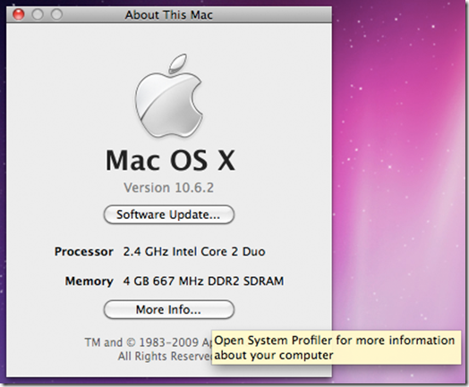

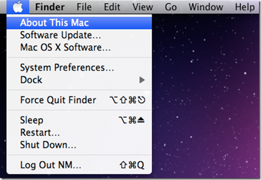

Have a look at System Profiler > Hardware > Disc Burning and see what DVDs your SuperDrive supports.
To go to System Profiler:
Click More Info...
Or press Option/Alt while clicking on About This Mac.
