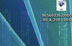

noone? just made a really weird observation today: I can actually take screenshots of the artifacts (see attachment)..
yes, they actually in the background in this case.. I can move an icon over it, remove it again and they are still waiting for me. Unfortunately, they're not always that well-behaved...

Could be a loose cable coming from the logic board to your LCD.
Could be a bad logic board.
Could be a failing video card.
Could be a failing LCD.
Those would be my guesses.
I'd check ifixit for some instructions on how to disassemble.
http://www.ifixit.com/Guide/Mac/PowerBook-G4-Al-15-Inch-1-1-5-GHz-BT-1-1/54/
And go in for some exploratory surgery 🙂 You've got nothing to lose as long as you're careful. See if you can find and check your connections.

I can take screenshots of the corruption too which re-enforces it is not an LCD issue.

My PB had screen replaced about a year ago as I cracked it. I have had the machine apart and all cables are solid, so its not a dodgy connection and it happens on DVI out as well.
I'm wondering if this has something to do with Quartz extreme or similar as this would all be disabled when booted from CD, and I assume the reason it is better under leopard could be advances in the QE...
