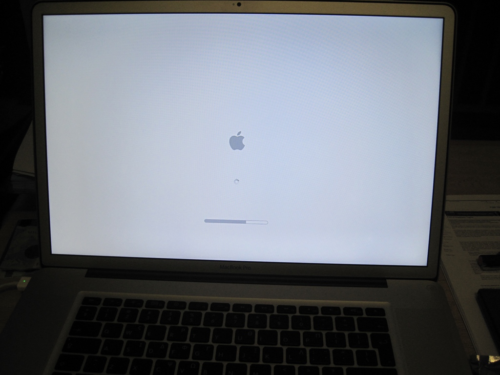

I have a MBP17 Unibody Late 2009.....I replaced the right fan with a new one....After the replacement, ALL of the startups, take about 15-20 minutes....I took a photo of the startup screen....I have Lion, I have unchecked the Restore Applications function, I had reset the PRAM and NVRAM, but still the same.....

That progress bar in that picture seems to suggest your starting up in Safe Mode.
Try these steps in order(your going to have Google some of them):
  1. Reset NVRAM & SMC
  2. Open Disk Utility, Verify your Partition Map & OS X partition
  3. Open Terminal & Run all the periodic scripts - "sudo periodic daily, sudo periodic weekly, sudo periodic monthly", Repair Disk Permissions, Restart
  4. Open Terminal & Check the permissions on your root - "cd /" then "ls -al@" (For SL I think they should be drwxrwxr-t root:admin)
  5. Boot in Safe Mode, Restart, Open Terminal & run "sudo update_dyld_shared_cache -force", Restart
  6. Re-build the kext cache - Open Terminal & Type "sudo touch /System/Library/Extensions/", Repair Disk Permissions, Restart
  7. Start in Verbose Mode and watch the startup output and see where it's going slow (Hold Command-V right after powering on)
  8. Check if your HD cable is seated properly
  9. Do a clean install of OS X
  10. Call Apple
You don't need to do all of them. If your problem is fixed then stop at that number.
