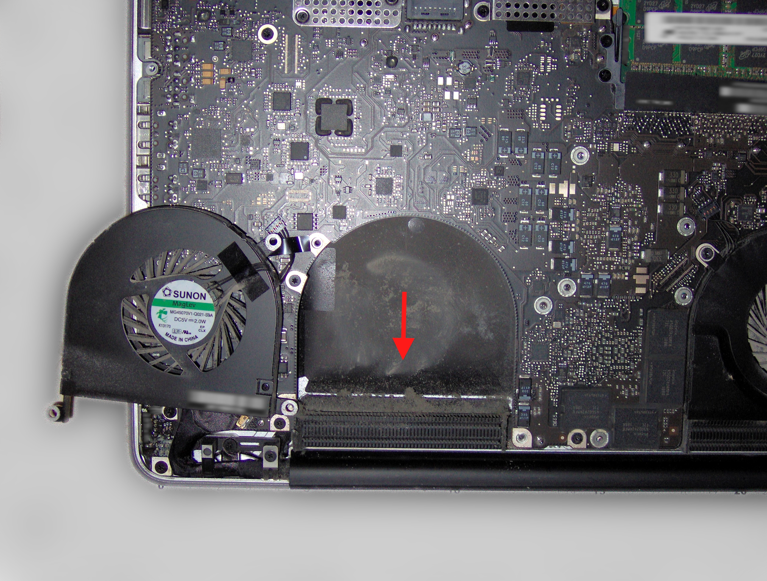

Canned air will not help removing the dust that sticks to the fans. I have recently cleaned a Macbook Pro (classic) and the only way to get the fans properly clean is to take them out and clean them with a brush, no chance of just blowing that dust away.

@pragmatous:
Compressed air does not remove thick layers of sticky dust (see example). I tested this. Only a soft toothbrush helps.
