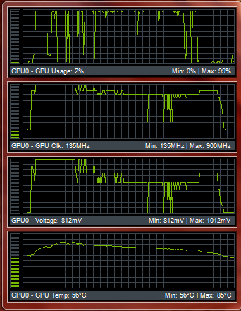

Hi,
I have an issue with my GT650M under Bootcamp (Win 7 64Bits, Pro Edition). Basically, the card can't perform well, even at factory settings (core clock speed of 900Mhz/memory clock of 2508Mhz).
During gaming, the GPU downclocks itself to 797MHz, then 725Mhz with spikes to 200Mhz, causing poor fps and massive stuttering.
What I've done so far :
- countless SMC/PRAM resets (with SMC update 1.1 installed)
- Throttlestop to prevent Turbo Boost for the CPU
- Lubbos Fan Control, with fans running at 5500 rpm
- fixed power state/clock settings with Nvidia Inspector
- High performance setting in Nvidia Control Panel and Windows Power Management
- Clean install of the latest Nvidia Drivers (driver cleaner under safe mode)
The only thing that seems to work, is to downclock the card with Core Clock Speed around 700Mhz and memory around 1000Mhz with Nvidia Inspector : lower FPS but no stuttering. Not optimal... and really far from default performance.

I think I've read something about the Macbook / Power Supply not being able to provide enough power for both the CPU and the GPU running with default settings (Turbo for CPU and stock clocks for GPU) on the Anandtech forums.
Something really possible here, given the huge drop in voltage on the Nvidia Inspector monitoring graph. Like the GPU just can't have enough power to run at full speed.

I did a bit of testing on bootcamp, with Aida64, the throttling seems to occur when the computer's power consumption reaches 80W. And I can't understand why, the power block is supposed to deliver 85W...
I was playing 1680x1050 and then I created a custom resolution in Nvidia Control Panel : 1440x900 (like my old 15" non-retina MBP).

Here's the setup I'm running with : GPU Clock Speed : 675Mhz - Memory : 1000Mhz (Basically a GT540M). Throttlestop with CPU Multiplier at 22 (CPU clocks at 2,2GHz). And Lubbos with fans at full speed. And I'm playing the Steam Version of Payday 2 (Resolution : 1440 x 900 and High Details). If I put a higher clock speed on my GPU, throttling occurs. Playing like this, the temperature barely ever goes above 80C.
And with default settings, I notice throttling around 85C (GPU) and 90C (CPU).
